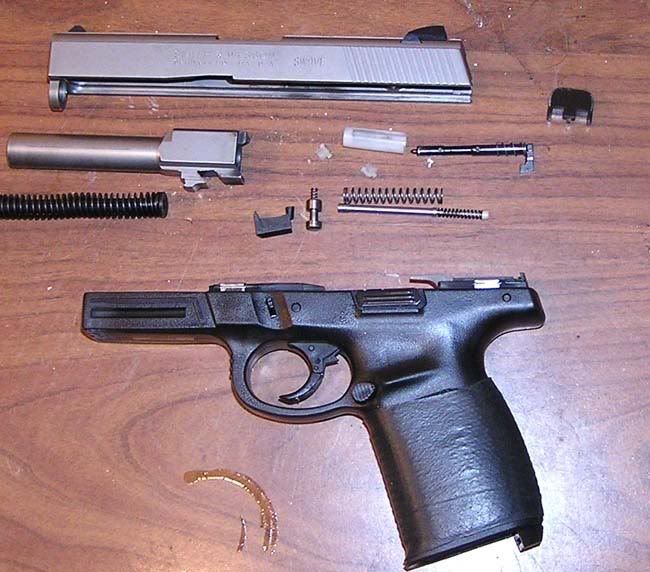

First, IllicitDreams brought his Sigma to my house. It has had approximately 400 rounds through it so no break-in issues should occur. We broke the gun down and I cleaned--but did not lubricate--the parts. I was surprised (although I shouldn't have) at what I found inside. The slide assembly is almost exactly the same as a Glock. This shouldn't be surprising since Glock sued S&W (and won) a few years back for patent infringement. Here's a quick breakdown of the gun:
Look familiar? Well, if your a Glock owner it should. I did not break down the trigger assembly because I am not familiar with the setup (and it isn't my gun) but the slide assembly is almost exactly like a Glocks.
Inside view of the lower:
While stripping the slide, a part of the gun (all plastic pieces are white on the Sigma as opposed to the black on the Glock) a piece of the striker assembly shot out across my basement someplace. After more than a half hour of looking with no success, I actually broke down one of my Glocks and the Glock part fit in perfectly. Of course, as soon as I had the slide assembled we found the original parts and I replaced them. So yeah--the Sigma has all S&W parts inside of it now.
Due to this parts issue, IllicitDreams and I sat down and compared each part of the slide assembly against each other. Here are the results:

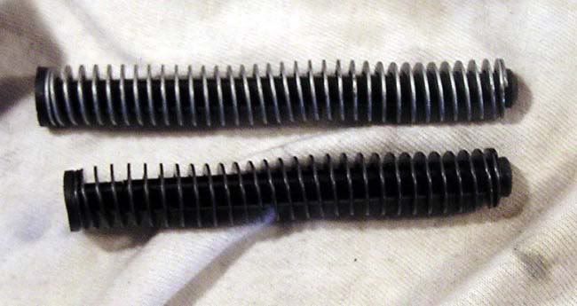

(All images have the Glock parts on top and the Sigma parts on the bottom)
As you can see, the plungers are slightly different--perhaps not similar enough to be interchanged.
Same with these parts
Extractors are noticeably different--the Glock extractor is too wide to fit into the Sigma
Yes, the Glock guide rod looks larger--this is because that is a G34 guide rod. When I used my G19 guide rod, it fit right into the Sigma.

Slide comparison between my G34 (obviously not cleaned) and a Sigma.
The slides were so similar, we decided to do a test:
the slide did not lock into place, although it fit onto the frame. The Sigma frame is slightly longer. When we tried to put a Sigma slide on a Glock frame it didn't work because the Glock ejector is in a different location.
The front sight appeared to be staked in place and also glued with some kind of polymer. Looked a bit off:
The Sigma also has some marks left over from plastic injection molding that the Glock does not. This is most noticeable on the trigger.
I weighed the trigger in at a very spongey 11lbs(!) No excuse for a trigger that heavy IMHO. I also do not like the non-standard rail on the frame of the Sigma.
