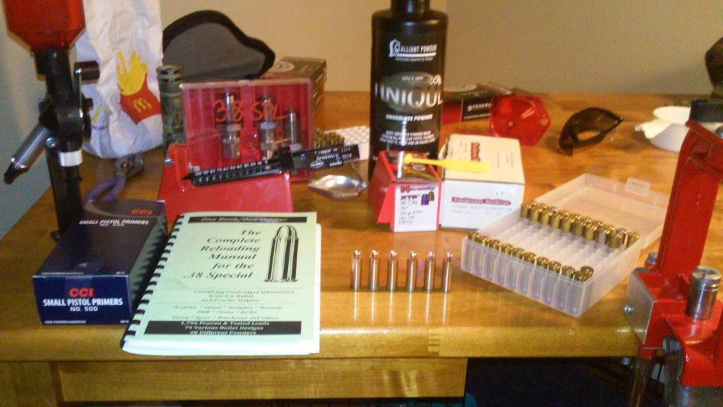

I've just started on a Lee single stage press. It's slow, but I'm enjoying it immensely.
Anybody have experience with the velocity needed to get a 125gr XTP to expand? Hornady says 800 IIRC but looking for first hand experience. Any load recommendations? I have Bullseye and Unique, currently loading the XTP on top of 5.5gr Unique from a 3" K-frame.
My little set up:
My little set up:
