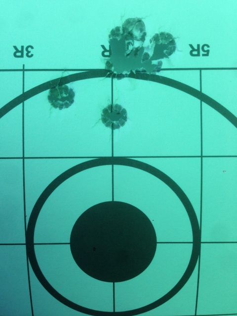

I found a good load for my 308, so no need to get a new one. For now anyway.
This was 10 rounds of .308 at 100m, fired off a rolled up hoody. 45 gr 2208 (AKA varget), Hornady 168gr AMAX, CAC brass.
