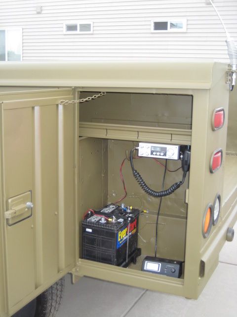

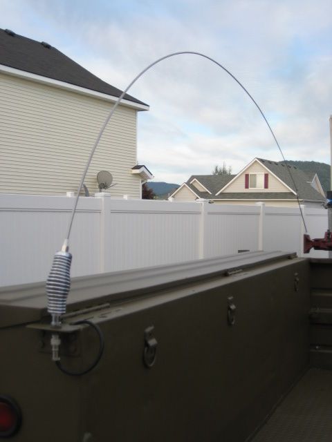

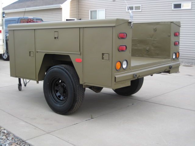

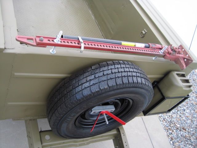

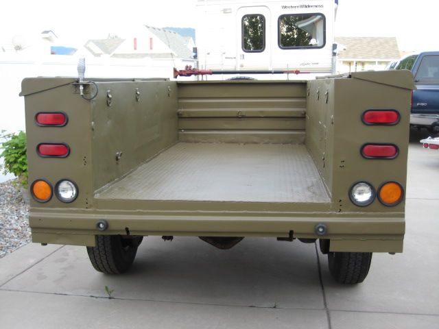

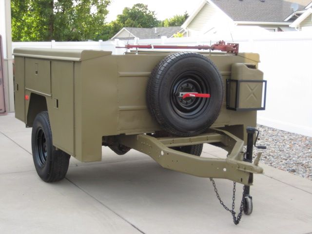

Started the next in a series of builds, Here is the bug out trailer, it's a utility service bed made into a trailer, I cut out the rounded fenders and squared them off to give it more tire clearance and make it more off road, all the doors lock and the top tray is long enough for fishing poles or firearms, the frame is from a 1 ton truck, it has heavy leaf packs and coil over shocks, I just sanded the whole thing inside and out and primed then painted it, I installed my own spare tire mount on front along with a gas can and a high lift jack, I then installed a 40 channel CB radio in the COMMS compartment along with a deep cycle battery, then I mounted a 102" stainless whip antenna out back. You could load all your camping gear, food, clothes, weapons, ammunition and fuel into it then when the time comes to bug out just attach it to you vehicle and go... I had plans to put a water tank and tool box in the bed, add a Canoe rack and solar battery charger. Also though about putting a shell on it and building a bed inside or looking for a duel sport motorcycle to put in the back, there are so many possibilities. I want to add a shovel and axe mount somewhere too. :arrow:

Not sure on weight, my guess would be 1000 to 1200 lbs empty, I'm working on a tailgate today.
It has mounting plates for a propane tank in one of the forward compartments. I will be looking for a water tank that will fit across the inside of the bed. Another nice thing is it has a fuel fill inside one of the compartments so I might go to a junk yard and pull a gas tank to mount underneath, stealth gas storage with a hidden fuel fill pipe :mrgreen:

Added some supplies to the trailer today!

Very nice... I would think it's more in the 1500Lbs. range empty, considering it's a 1 ton frame and axle. Did you pull the guts out of the pumpkin?

Yeah... the guts and gears are pulled out of the pumkin, no need for them and it greatly reduces weight. How to make a heavy trailer as light as possible! :rofl:
Oh and I just picked up a ham radio and an 11 meter radio for the comms compartment! My sister called me from a yard sale and said "You gotta get over here" so I went and bought the two radios! plus I just came into possesion of a nice 2 meter radio as well :mrgreen:
I am going to have to add another shelf to the comms compartment and enclose and vent the battery.
