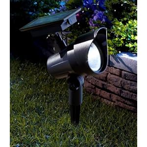

There is good advice here. In my yard I have "ambient lighting" which goes on at dusk off at dawn. It is low level and provides nominal illumination using either LED or CFL bulbs. To this there are motion sensor par 38 flood lights aimed so that as I walk the path from the house they go on in front of me. BTW do not use PAR 38 CFL on motion sensor fixtures. They are slow to power up and develop full brightness. Use simple halogen bulbs on motion sensors lights.
Then there is a set of flood lights on the roof line front, back and side that are controlled with manual switches. These are power hogs (about 1.8kw) with all of them on and rarely used but the logic is simple. If I need light; I want a lot and I want it now. To hell with a flash light.
Installing these can be DIY but honestly unless you have done it before I suggest paying an electrician to do it right and safely. It is simple but it can be dangerous if you not careful.
I am going to throw out another alternative only so that you have some choice. I have found these solar powered LED lights to be quite useful as long they can get 10 hours of sunlight. They do dim over time at night but they are useful to illuminate areas where running conduit is a PITA like the far back yard. While this picture has a ground spike they also come with a regular mounting plate so you can attach them to a fence or a roof line with a few screws and be done with it.
They work better if you replace the nicad batteries with rechargeable Li ion AA batteries.
Again these are more for ambient light purposes but any light sometimes is better than no light.
I have tried several of the solar powered flood lights with motion sensors on them. I have yet to find one that works well for less than $350. For that cost you can simply run conduit.
That said I did recently purchase this home depot and so far it seems to be performing ok in that it does go on and off and the light output is bright but the beam throw is limited. It also is not very weather resistant since the solar panel is not hard wired to the battery. Never the less it is an option.
