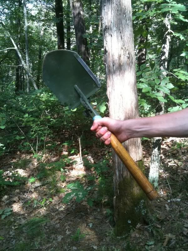

My first impression was one of optimism. The steel seemed strong and the handle wood hard... (Giggity) The case fabric is thin but the stitching is pretty good. My only complaint about the case is that the saw blade side of the shovel snags on the corner of the case. I'm considering making a kydex insert to fix this.

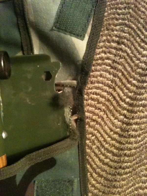

The back of the case had webbing to make a belt loop so I popped the stitching and used the webbing to make it MOLLE compatable
Now it fits on the back of my Maxped Kodiak
So I give the case a 2.5/5 stars (after MOLLEfication)

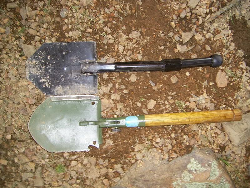

-Shovel/Pick
The day my shiny new E-tool arrived I just had to try it out in my back yard. The dirt is somewhat hard but with few rocks and lots of tree roots. I found a spot where my wife wouldn't object to a small hole and began hacking away. Immediately I found that the weight and balance was not too bad and the beveled edge helped it cut through the dirt pretty well. A light swing in pick mode would cut in about 1.5-2 inches (I found this satisfactory considering all the digging I've done here in the past) At this point in time I was not sure how the locking mechanism would hold up so I was admittedly being gentle. I produced a small hole quite easily and decided that was enough digging till Z-Con.
At Z-Con the pick was used to dig out the side of the mountain to level out camp chairs at base camp. Those of you that have seen the mountain side it is rocky as hell, more rock than dirt. 2 E-tools were used for this specific task something that looked like a glock E-tool (we weren't sure who the manufacturer was) and the CWS. After 2 days of tip torturing this is what happened
CWS:1 Nature:0

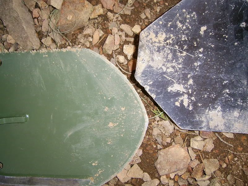

As you can see, the pseudo-glock couldn't cut it on the mountain. The tip bent on the second day, and although the severe angle cut through the dirt well, The sheet metal it was made of couldnt handle the rocky terrain. The CWS Had a few minor nicks along the blade and continued to stay in that condition for the rest of the week. The locking mechanism held up well and showed no noticeable differences.

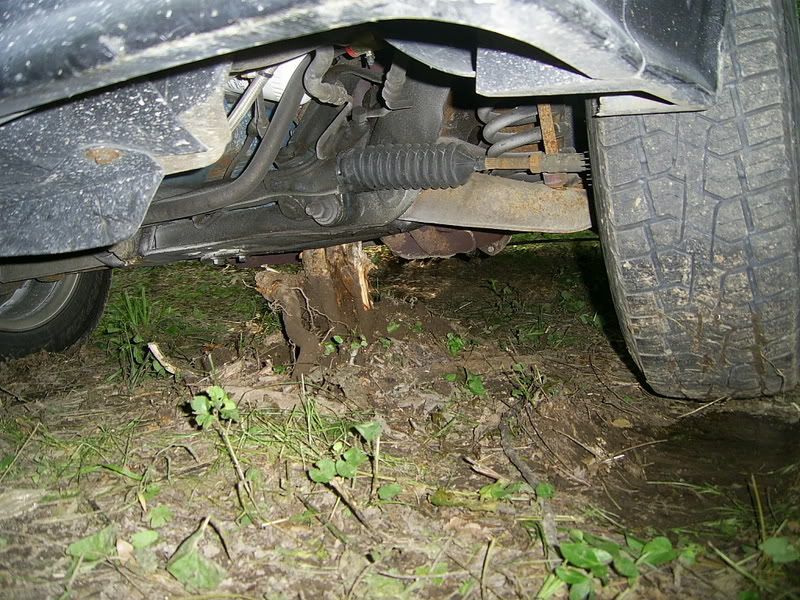

At Z-Con we had an interesting curve ball thrown at us with one of the vehicles. It snagged up on a small tree stump in the parking area.
After jacking up his car and getting it off the stump, I gave him the CWS and let him whack away at the roots to remove the stump. He pulled no punches and swung with blind rage till the stump was out (somewhere around 10-12 swings). I guess he was mad at nature trying to violate technology.
CWS:2 Nature:0
I almost felt pity for my new gadget till it pulled through with nothing but dirt to wipe off. After several other hacking events only small nicks were produced in the blade that were easily touched up. The locking mechanism still has no noticeable difference in play.

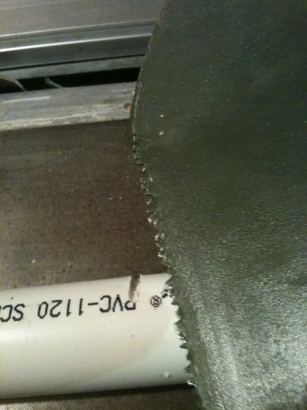

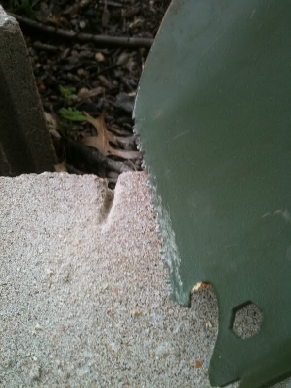

-Saw
The teeth to the saw are staggered 2 to 1 this helps keep the blade from binding. However, the fact that the shovel itself is curved puts a bit of a hindrance on making deep cuts. Each one of these pictures is after approximately 50 passes with light downward pressure.
Green tree branch
1" PVC
Cinder Block
I tried a nice soft piece of copper pipe but did little more than scratch the surface
I would say that the saw works and in the woods it's better than nothing. If I need to cut larger limbs, that's what the hatchet is for, however, using it for small cutting tasks like notching wood it would work well.
CWS:3 Nature:1 (I gave them each a point because it cuts, just not great)
Saw 2/5 Stars

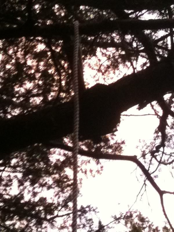

-Grappling Hook (Anchor)
As I mentioned before the set screw fits into specified holes along the hinge. One of these holes locks the blade at a 45 degree angle. Along the hinge is also a large hole designed (I assume) to thread a rope and tie it off. Doing this then wrapping a half hitch around the top of the handle is how you turn your CWS into a Grappling hook/Anchor. At Z-Con I found a sturdy tree branch and threw my trusty shovel. On the first throw I hit my mark and it actually hooked on (results may vary).
admittedly, these photos were taken near sundown with my phone (stupid camera)
Finding volunteers to test a "magic" shovel were hard to come by. Kevin threatened to kill me with the CWS if anyone hanging from it were to get injured. I wanted to find someone that would be heavy enough to prove the point... I had to settle for Hawk being the only one crazy enough to put his faith in my knot tying skills while I took pictures.
I call this one "Grappling Hawk"
Also, here is a video of the guys at http://www.greenbeetlegear.com doing their own test of the grappling hook feature.
http://www.youtube.com/watch?v=A0W0g_7jG1k
Side note- we discussed using this as a boat anchor but I didn't try it from fear of loosing it in the river.
CWS:4 Nature:1
Grappling Hook 3/5 Stars (I'll increase the rating once i find a heavier volunteer)

Awesome review 1SR437... you really hacked that thing to its limits... (ooh see what I did there !!)... anyways.. Not sure if we'll be able to get that shovel imported into the UK but I will certainly look into it.. I was going to go for the Gerber folding shovel for my BOB but I may wait out for a bit till I get an answer from the supplier.. I may be able to get it APO to where Im working.. but not too sure...
Right.. in the last pic of the post you're holding the shovel up... is that some sort of "guard" on the top edge of the shovel or is it just the photo ?? Just that you dont mention it in your review.. It may just be me..
Thanks again !
