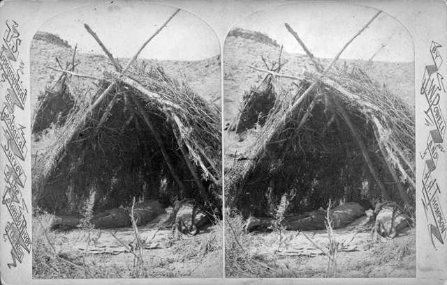

re: the bastardized tipi/smish kåta style One might see this as a
Paiute Wikiup!
Well, without the snow that is.
