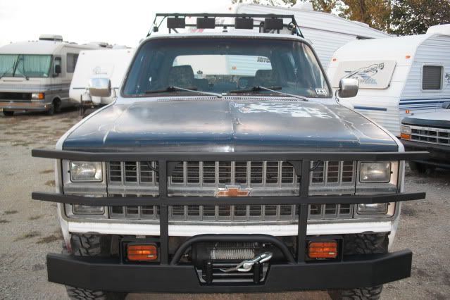

Or what I’ve been spending all my time and money on…
So it’s an ’81 Chevy K5 Blazer. I got it with a fresh crate 350, turbo 350 and good tires. Otherwise, bone stock with your average busted and rusty parts an pieces. I have big plans for it but for this thread I’m gonna stick to what I’ve actually done to it. Of course if you wanna know what my future plans are I’ll tell ya.
This is shortly after I got it. I hadn’t done anything at this point except tint the windows and add the POW plate an ZS stickers. The smoke is not the engine, lol. We’ll get into that later.
First off, patch holes. Fiberglass cloth, jelly, foam and some time and it’s gtg for a bit longer.
Decided to rip the interior out next. Painted a lot of plastic and around where the door panels fit. Added new weather strip, sound dampening mat, and mylar coated foam sheeting to the doors. Cleaned and/or replaced dash bulbs. Installed black coated SS window vents on each side.
And chopped a big hole in the dash because I need more space. A little hail screen and fiberglass later and I had this.
I forgot my camera the day I put in new seats, but these now both tip forward and recline completely, as opposed to the standard Blazer seats that don’t do either. I put in new covers and mollee panels on the backs for additional storage. Also installed helicopter jump seats in the rear.
About this time I installed new manual locking hubs, new shocks, heavy duty steering stabilizer, headers and had a shop install new exhaust from the headers back to the resonator tips I provided. No pics, not to exciting.
I did however, decide I needed a gun rack. So here’s what I came up with. Piece of a phonebook wrapped with duct tape with metal behind at an angle to deflect any possible ND's in cab. The yokes slide forward and back to accept any length of rifle.
I sanded down the exterior shell and repainted it and well, you gotta have a roof rack, so I built one of those. Also installed new weather strip on the back window.
And a light bar.
You may notice in the above pics a step designed to be put into the receiver mount (yep, put a hidden hitch on too). But the step is important because next project is a body lift.
Now that the body is up I can start new projects, like fixing the rusted out places in the bed.
I knocked out a few little things at this point just to get ‘em done. Like replaced the shitty busted plastic door handles with wood ones.
Painted some more of the interior plastic.
Fabbed up a mount for my battery isolator and remote inverter.
With the body now at the height I wanted it, I knew where to mount the new bumper. I just had to build it yet. So I busted out the welder again and here’s that.
And a heavy bumper deserves a heavy winch. 1200 pound hydraulic. Tucked in under the truck. The bumper is now 3/8 of an inch closer to the truck than the factory one was.
And more bumper to keep the zombies outta the radiator.
Had to mod some lights to accept the stock bulbs so I’d have blinkers.
Some primer and paint and we got this.
As it turned out, a guy backed into it just yesterday at the mailboxes. He said it was very solid, lol. Fortunately it didn’t hurt his little S-10. I think he just hit my tow hooks (installed after the last pic), because I can’t even see a scuff on my bumper.
Well that pretty much brings us up to date on BOV progress. I’ll update this thread as I waste more time and money. Questions and comments welcome.
TL DR; That’s why there’s pictures.

Postby Regulator » Tue Dec 07, 2010 12:32 am
Kevlar, Well sure. *You don’t have a ZS Rd where you live?
USMCSergeant, I’ll try an get you a couple pics tomorrow. As far as paint goes, I’d really like to paint it digital camo in black, white and grey like my bike. I’m a bit torn though because currently no-one looks twice at the truck, the bike may as well be neon pink as much attention as it gets. I sorta like being invisible in the truck. Future plans include rear roll bar, pipe bumper, can/tool racks, lower exoskeleton, snorkel, gear drive, and the fun stuff like smoke screens and rocket launchers. :mrgreen:
Dom LRS, That’s a great idea I hadn’t thought of. I have considered putting a cable cutter vertically on the front bumper that would fold up and lock in place to protect the windshield/my head.
man in black, You made me lol for real. Glad you like it. You decide to do one yourself I’ll give ya any info you need.
*Kevlar, It’s photoshopped. Tryin not to tell the world where I live. Good eye though, you caught it quick.

Postby Regulator » Tue Dec 07, 2010 11:10 pm
USMCSergeant, Here’s a pic from the side. 21½ inches from ground to rocker panel, 19 from ground to bumper. Diffs are lower of course but I didn’t crawl under to measure.
maldon007, Yeah… I have about got myself talked into it. I have a few more things in mind to do before it would be ready for paint though. Maybe next year.
6UNF1GHTER, Thanks, and yes, it is a 205 T-Case. The winch runs off the steering pump. I have the military version, but the civvy version is Here I added tow hooks to the bumper within a day or two of that pic. You can see them above. The rear bumper just has the receiver hitch, until spring anyway. Blackouts and infared are on the list too.

Postby Regulator » Thu Dec 09, 2010 9:15 pm
6UNF1GHTER, Oh yeah, about that… around 9mpg, lol. Bit in it’s defense, it does run fully loaded with tools, recovery gear, extra parts and fluids, tall and wide tires and a lot of extra steel. 33 gal tank, so almost 300 mile range.
db_tanker, They used to use a lot of salt back when the truck was young. Now it’s mostly some liquid chemical. And don’t feel bad, the mountains are hard to find.
Matsuo, Just a 3 inch body lift to give room for larger tires and enable me to mount the winch under the radiator to keep the truck short. I have helper springs to install that claim another 3 inches but I got them just for increased load capacity. We’ll see how much they raise the truck.
The roof rack is attached with 3/8 bolts backed up with fender washers. Tailgate windows are notorious for going bad. Mine is electric and would jump a tooth or two sometimes and get crooked. I fixed this by bending both gears down slightly and then putting a strip of plastic under them. The gears now run against the plastic but the bend keeps them meshed. I will no doubt have to replace the plastic periodically. ’76, that’s the first year of full tops isn’t it?

Not sure about what years and the varieties of tops, but mine is just like yours minus the sliding windows.
This time last year I moved and my truck was my main moving vehicle... overuse of the tailgate and the constant cranking up and down of the window several times a day over the course of a week destroyed what was already a rickety crank and regulator.. :x I opened it up and the mojority of the crank and lock components just fell out. The lock and the gear interface pinion are pot metal, though the gears are steel the frigen pot metal they were riveted to just disintigrated. If I could figure out a lift up style window I would and just eliminate the 'crank the window down into the tailgate' option all together.
Also, that's some mighty fine welding... I sure could use your help on my truck..:)
As for paint... Needs more ZS...LOL
