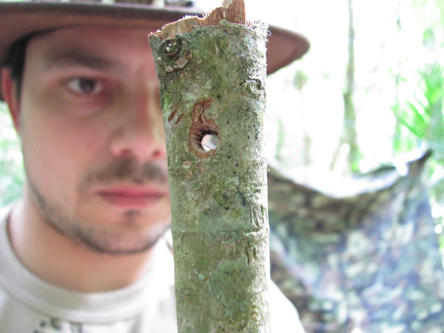

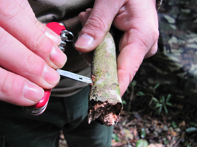

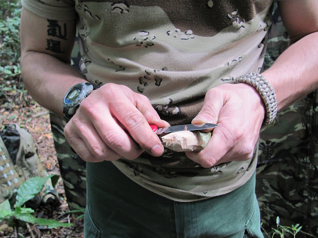

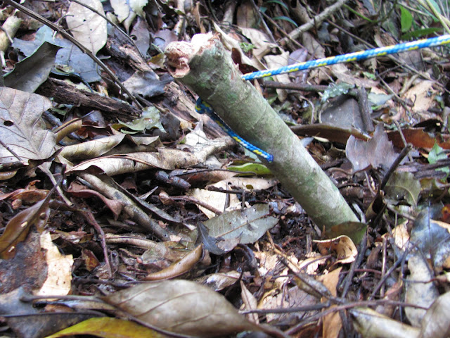

Postby JoeTosco » Wed Sep 08, 2010 10:43 am
Yesterday was independence day in Brazil, and I used the day for testing my new hammock and tarp.
Since the objective was merely testing, I didn't bother to make pretty stakes, just functional ones.
That's the result:
As I said, not a thing of beauty, but get's the job done.

Re: Making tent (or whatever) stakes
Postby ninja-elbow » Tue Sep 14, 2010 5:10 pm
Wow, good job. I never thought to auger a hole through the stake itself but I can see the advantages.
