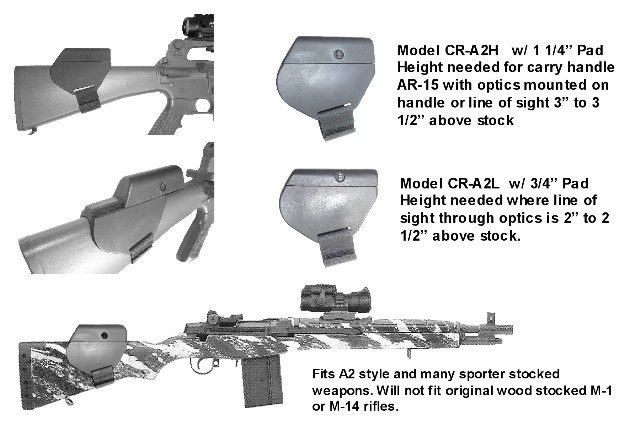

Basically, I want to take the kydex sleeve from this:
adjustable comb
and put it on this:
adjustable butt.
This should give me a very low profile adjustable stock.

Postby MTechnik » Sun Feb 28, 2010 3:04 pm
I wonder how steady that comb will be when attached to a telescoping stock bit like that, especially it being a rubber one that you are screwing the comb riser into. I'd look into something like the "accuriser"

Postby jamoni » Sun Feb 28, 2010 3:22 pm
Hmm. It may be a little unstable, at that.
However, the one you posted is ugly as shit. :)
However, I wasn't planning on screwing it into rubber. I was going to drill and tap the metal part.
Now that I look at it, though, neither the kydex nor the adjustable butt is what you'd call difficult to make. I may just whip up something in the machine shop that's better.

Postby MTechnik » Sun Feb 28, 2010 3:32 pm
jamoni wrote:However, the one you posted is ugly as shit. :)
But functional, stable, and easily removable.
Also, the one you posted may not go far forward enough, if you like having your nose within 3" of the charging handle.
