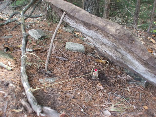

First up is a modified Paiute deadfall. The modifications are (1) the vertical stick has a natural fork to hold the horizontal stick and (2) the vertical stick is pushed into the ground. This makes the trigger much more stable. Be sure that your rock doesn’t hit the vertical stick on the way down.
The baited area is shown in red. This end of the stick touches the rock, the other end simply keeps the cord from flipping around the vertical stick.

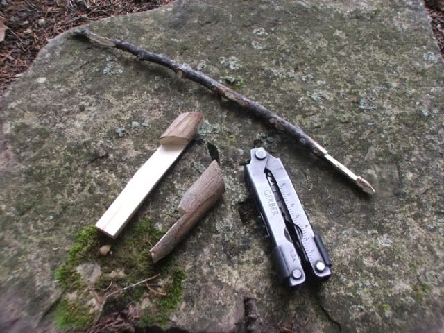

Here is a close-up of the trigger. I have use natural cordage but anything will work fine. The Gerber is just for scale.

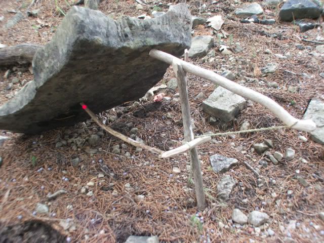

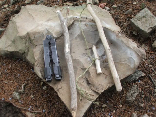

Next up is a very simple trigger. Here you are relying on pressure to keep two round pieces of wood against each other. The slightest movement makes them slip and sets off the trap. On this trigger, you can set the trigger before you place the rock as separate pieces of cordage are used for the bait and rock.
A limb or stick under tension is held by the baited part of the trigger. In this case I am using a dead cedar branch still connected to the tree. You always want to use dead wood for your spring sticks as green wood will bend and lose it’s springiness. The stick holding the rock up is tied to the spring stick with a different piece of cordage. When the trap is set off, this cordage pulls the stick out and releases the rock. This trigger works well horizontally also. Bait placed where the red circle is.
A close-up of the trigger

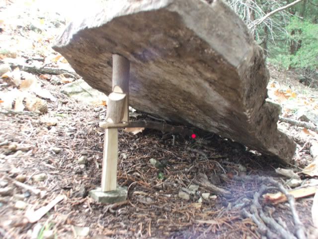

Now I said most were easy. This trigger is a bit more complicated to build but damn it’s slick. It also is well suited for areas where the rock cannot drive the trigger parts into the ground when it falls. The trigger is released by movement an any direction. A good trap for birds as well as they will perch on the stick to eat the bait.
Basically the downward pressure of the rock makes the two larger sticks want to spread apart at the bottom. The bait stick is notched and holds them together until tripped. Hard to explain, easier to see. Bait placed where the red circle is. The baited stick does not touch the rock in this trap.

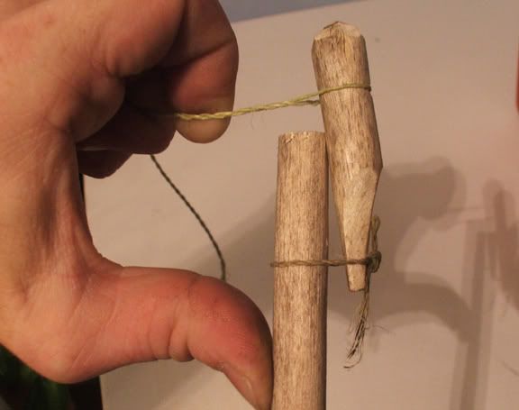

Thought I’d add a couple more extremely simple deadfalls to this thread. These two require no cordage, are easy to set and so simple to build you need no instruction other than seeing the pictures.
This one is similar to the Paiute but requires no cordage. You do need a solid base to keep the stick from sinking into the ground from the weight of the rock. Bait goes where the red X is.
And video (click pic)
The second trigger just balances a pointed end against a round stick holding the bait against the rock. Baited at the red X.
