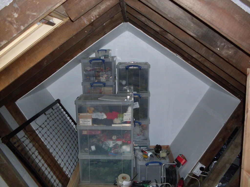

Final managed to get a couple of pictures of the “Bunker”. Please remember this is a work in progress and I am not a talented builder. This first picture is from the loft ladder looking south,
I have installed windows in the East and West sides of the roof. Centre height is 6 feet 2 inches.

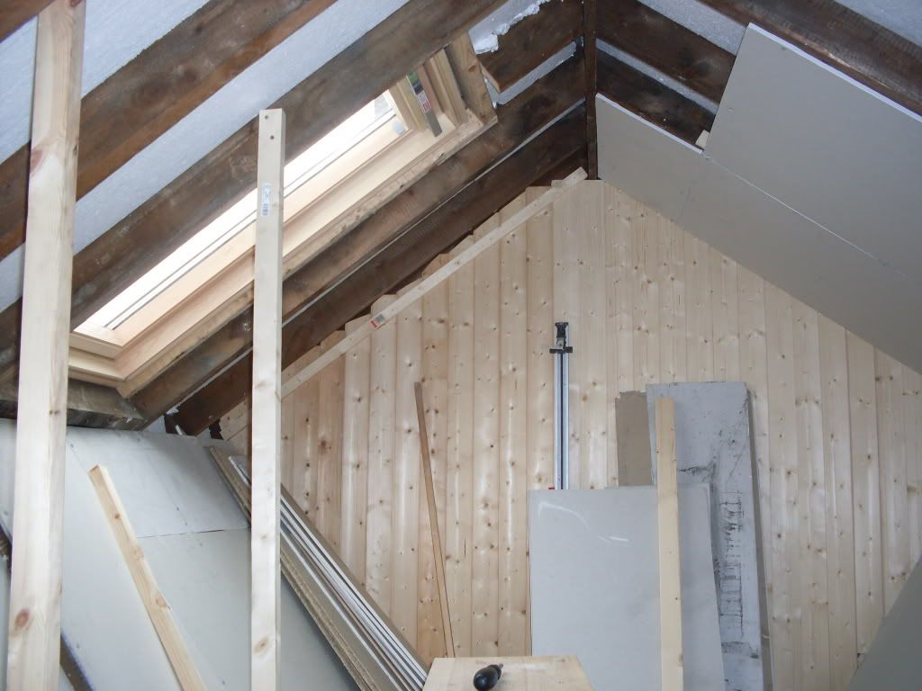

The second picture
Is looking north. I have already plaster boarded & painted this end, some of the box’s contain my gear, but I notice “she who must be obeyed” has been putting the Christmas decorations there as well.
I intend to put a work bench & shelves along the wood panelled end. After working up there this week I have noticed the insulation is working, even with both windows open, so I need to install a fan.

Looking good! If your loft is anything like ours it gets REALLY hot up there during the summer (and we have no insulation between the rafters) - those windows are going to come in handy.

That looks pretty good dude. I need to have a go at sorting out my loft at some point. I wouldnt know where to start though. I suck at anything like that.

Post by K9medic » Wed Apr 15, 2009 12:59 pm
Boarding the floor was the easy bit. I used packs of chip board flooring from B&Q. It’s designed for lofts, right size to go through the loft hatch and still fit centre to centre of the beams. Then screw them down. I didn’t put extra insulation under the boards in case I pushed the plaster off the ceiling.
The hardest bit was fitting the new loft access. I needed a decent ladder rather than one of those slide down aluminium ones. Was a little scary cutting through the Beam, but since the roof didn’t collapse I must have got it right.

Make sure you stack them boxes over wall s below to give more chance of it spreading the load....
Last thing you want is to brained in the night by a load of supplies.... :wink:
early warning sign is the plaster - board nails poppin`
saw a plumber once who didnt shore up the new immersion tank in the attic......came back after filling up the next morning to find it two floors down !! :lol:
