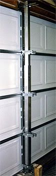

Down in SC (on coast) we have to be built to hurricane type code. The garage door in my house has a hurricane reinforcement kit on it which is basically metal studs laying on the short side against the door across each panel of the door (they are fastened with lag screws to the door). I am pretty sure they sell this as a kit an you may be able to get it or order it from Home Depot, Lowe's or a Garage Door installer in your area....
ZombieKraft
Posts: 521
Joined: Tue Jan 09, 2007 7:38 pm
Post by ZombieKraft » Sat Dec 15, 2007 6:58 pm
rflemen wrote:Down in SC (on coast) we have to be built to hurricane type code. The garage door in my house has a hurricane reinforcement kit on it which is basically metal studs laying on the short side against the door across each panel of the door (they are fastened with lag screws to the door). I am pretty sure they sell this as a kit an you may be able to get it or order it from Home Depot, Lowe's or a Garage Door installer in your area....
bob vila has a thing or two on this
http://www.bobvila.com/HowTo_Library/St ... A2021.html
Secure Door is the only Florida Building Code approved garage door retrofit kit available on the market, and it is also designed to be installed by the do-it-yourselfer.

Yep that is it. My Garage door looks exactly like that first pic...
ZombieKraft
Posts: 521
Post by ZombieKraft » Sat Dec 15, 2007 7:28 pm

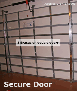

This video is pretty informative:
http://www.securedoor.com/index.php?page=dsl
The system looks simple enough that you could probably make the same setup out of steel poles and a little bit of hardware. Their aluminum poles seem to bend in the video so steel might be better anyway (who knows sometimes it's good for a door to give a little).
Nice to know for those who are short on change. That's pretty amazing. Original door failure at 70mph and this simple addition strengthens it to 180mph. Now all you need is some precut 10 gauge sheet metal to strap to the outside of the door and your garage doors are completely secure! If anyone wants to look at he parts the installation PDF can be downloaded here:
http://www.securedoor.com/index.php?page=installation

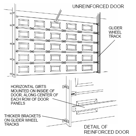

Heh this is what FEMA wants you to do:
http://www.fema.gov/pdf/plan/prevent/howto/how2016.pdf
Looks like their advice sucks about as much as their response to Katrina.

Pretty much common sense. It looks like garage door makes up 80% though. So this little device is a godsend. Thankyou rfleman!

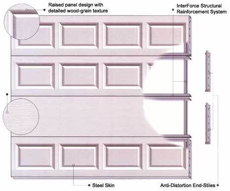

Looks like schmucker is the best doors I can find that still look normal:
http://www.schmuckergaragedoors.com/doors/dab.html
only 24 gauge steel though. Anyone know of any better?
The result was the Hurricane Master™, the industry's first garage door system engineered with a structurally reinforced load-component concealed within the perimeter of each door section. This patented structural component transforms the door into a monolithic wind barrier that is better able to resist the effects of severe windstorms.
Built-In Windload Resistance System in Each Door Section
Extensive independent testing confirms how DAB's Hurricane Master™ is able to withstand the intense pushing and pulling effects of extreme wind velocities from 90 MPH to over 150 MPH in both coastal and inland wind zones for the broadest wind coverage available.
Slender 2 1/4" u-bars can be easily added to meet and exceed the strictest wind codes.

ZombieKraft wrote:Heh this is what FEMA wants you to do:
What's wrong with this? It's not comprehensive in the least, but it helps to reinforce the panels themselves. Getting stouter brakets isn't the end solution, but it's way better than nothing.
Be it raiders or weather, it seems like there are 4 forces you have to worry about:
1-lifting up on the door
If I were a raider, I would try this method before anything else, since it's the way the door was designed to move. This can be solved by bolting a _| |_ to the floor with anchor bolts and then bolting a T to the bottom of the door so that the "stem" of the T fits between the two brackets. Then you could drill a hole through all three and slip a bolt in it when you need extra security (this could be for special occasions or every night, depending on how worried you are about your door).
2-sucking "out" on the door
This can be solved by something like the securedoor system that Zombiekraft shared with us (thanks btw). Either DIY or buy a kit, you choose. The FEMA suggestion of strengthening the individual panels helps this too.
3-pushing in to cause torque on the hinges and bend the door
This is the classic battering ram to center mass idea. Because of the torque being exerted on the hinges and tracks, this seems like the thing to worry about the most. See number 2.
4-pushing in to knock the hinges off of their bolts
This is taking a sledge to the corners of the door because the tracks are usually the weakest parts of the door. The door itself remains relatively whole, it's just taken off it's mounts. The tracks could be reinforced without inhibiting the movement of the door by bolting a U-shaped piece of steel around them.
