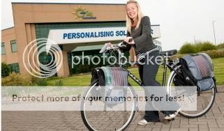

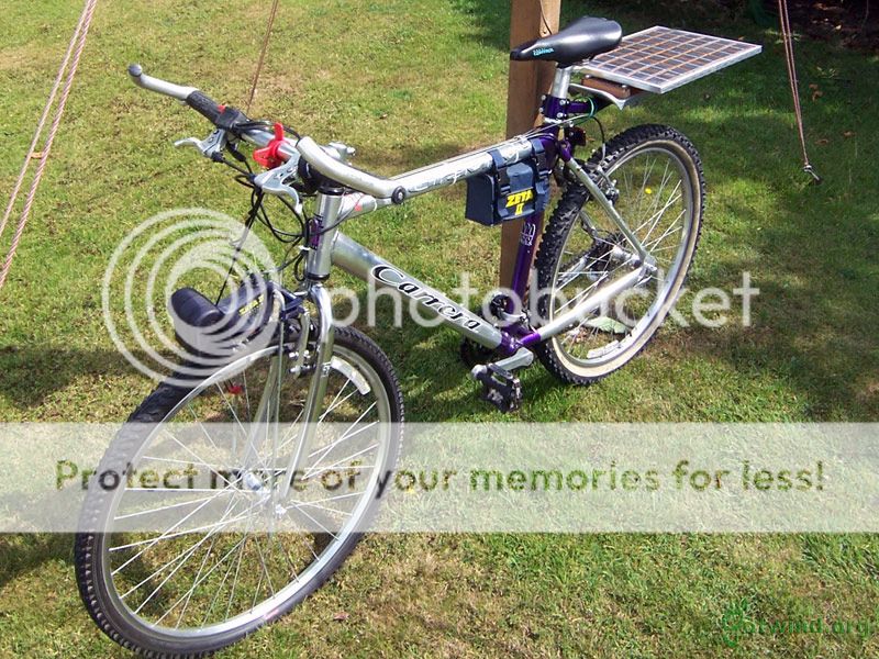

Weight reduction and range solution: put an emotor on the cranks and you can use a smaller motor. You lose regenerative braking but a 200W motor will suck a lot less juice than a 750w motor. It also makes it so that you have to pedal to use the motor.
Entending range and refueling while using the bicycle for a bugging out:
Recharging electronics...
Rear hub motor with solar charger on trailer and batteries are on the bike, that's 100 liters of cargo space in the trailer.
Battery pack is by the seat post, motor is over the front wheel - still a short range deal here though.
Also, going this route means that, in Washington State at least, it's not a vehicle plus it gives you options an ethanol motor doesn't have.
Pre-ZPAW, pick your poison. Bugging out pre-SHTF, I'd go the electric route personally. Post-SHTF the emotor wins, hands down, IMO, but YMMV.
