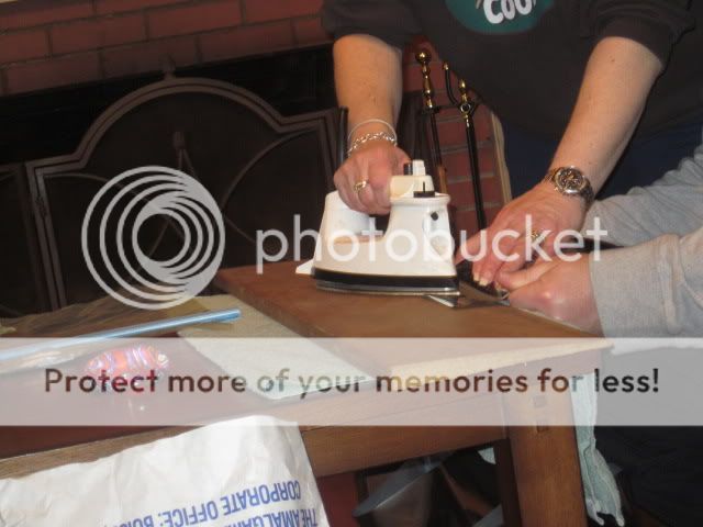

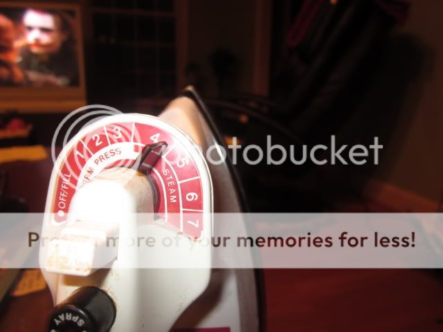

We have been using our iron to seal our mylar bags. We set it just below the "Steam" settings (If it gets into the "Steam" area, it is too hot for the bags) this is plenty hot enough to do the job. I wanted to add this for those that don't have special sealers, this can all be done very easily and effectively.

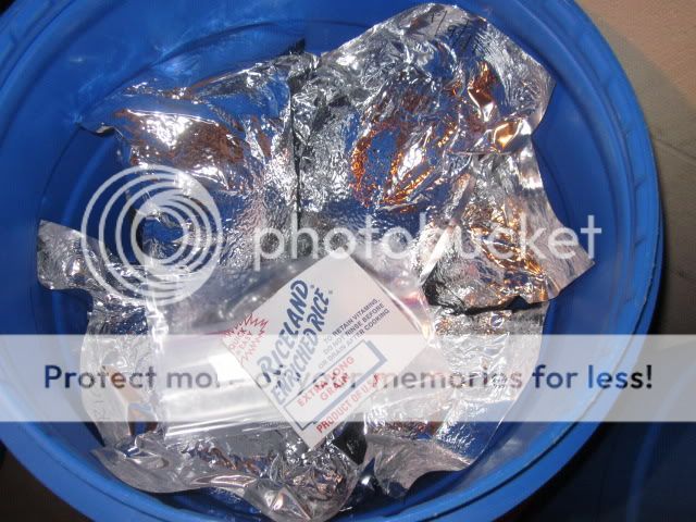

We have also been adding 2-3 large ziplocs to all of our buckets, for when we have to get into our food storage. We are looking for good scoops to put in each bucket.

Can you better describe the technique?NoAmnesty wrote:We have been using out iron to seal our mylar bags. We set it just below the "Steam" settings (If it gets into the "Steam" area, it is too hot for the bags) this is plenty hot enough to do the job. I wanted to add this for those that don't have special sealers, this can all be done very easily and effectively.
Great post! Thanks for sharing!
Do you iron across a board or piece of rebar for a well defined seal?
Do you place anything between the iron and bag?
What thickness of bag do you use? 5 mil, 7 mil?
How long do you apply the iron?
Etc, etc.
Thanks

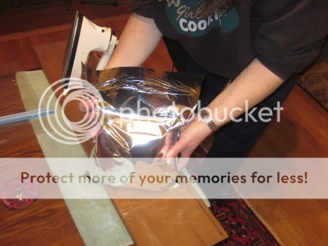

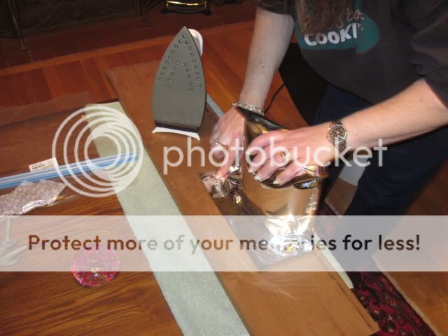

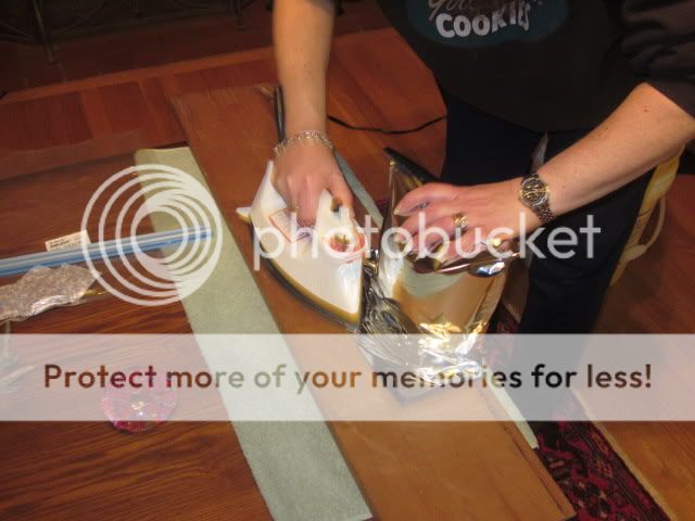

No prob, it's really easy!
We lay a towel on the coffee table and a board over the towel.
Mr. NoAm holds the bag and I slide the iron over the end of the bag (literally just slide, it doesn't take much pressure)
We seal the bag about 80%.
Then I take the bag, stand it up and fold the top over to press out most of the air.
Put the bag upside down (folded) and seal the rest of the bag.
This can be done by 1 person, it's just a bit easier with 2.
We have done this with both 5 & 7 mil bags.
Powdery type of items like milk & flour can be really messy, so I wipe the bag with a barely damp paper towel and then follow with a dry paper towel and seal the rest. We now buy the milk in the #10 cans and dry vac seal our flour in 1/2 gallon size mason jars.
I will take pics this weekend when we finish up the dry food we got last week.
We did several 100 #'s of rice, wheat berries and carrots.
We will be doing sugar, cocoa and potato flakes this weekend. We find that a metal scoop works better with the powdery items. We have tried plastic cups (It sticks to the sides), glass measuring cups worked better, but the metal scoop worked the best.

Sealing the mylar bags with an iron
Set the iron just below the steam area (each iron will probably vary, do a little testing to see what works best for you)
With a towel on the table and a board on the towel.....................
Have one person lay the open end of the bag on the board and one person seal the bag 75% - 90% closed (90% for the fine powdery items)
Gently fold the bag to get all the air out you can (This is where you have to be very careful with powdery/flaky items)
Put the bag back on the board and finish sealing (I do another once over on the entire end again)
Picture of the completed sealing
You can see how the rice we have done sealed down and you can see the formations of the rice in the bag
We also cut out any special directions or warnings, toss them in the top of the barrel and add a couple ziploc bags
for when the items have to be opened for use.
