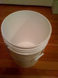

1) Get a clean food-grade bucket and lid. If it's used, make sure it was used for food. Food grade plastics are denominated by a number inside three chasing arrows (the recycle logo). Numbers 1 and 2 are best. 4 and 5 are OK if you use a Mylar liner. 3, 6 and 7 are not OK. Edited to add from the tips posted below: You can use anything, a carboard box, a tupperware container or nothing at all if you are using a mylar bag. The bucket only gives mechanical support to protect the bag and make them stackable and provides a container to eat from later. A good bucket is more important if you don't use a liner. But you should use a liner.

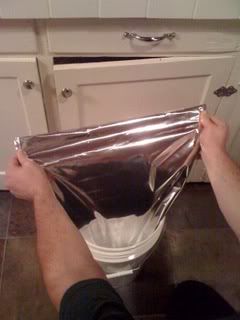

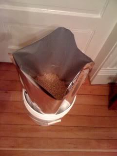

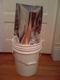

2) If you are using a Mylar liner, squeeze all the air out of it, then inflate it in your bucket with CO2 or Nitrogen. CO2 and Nitrogen are heavier than air so an open top won't release all the gas. The more air movement you have the more air will get into the bag though. Alternatively if you aren't purging the air, just put the liner in the bucket and open up. No big deal. In the picture you can see that there is a lot of extra bag sticking out of the top, there will be less when the bag is filled but still plenty to open and reseal the bag a few times.

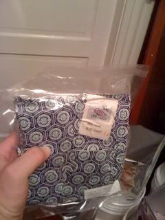

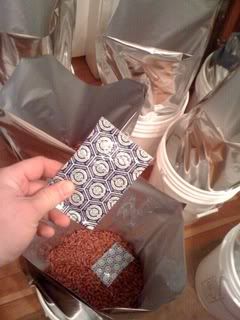

3) If you are purging the air, put in a desiccant pack sized for your bucket. If you are not purging the air, put in an oxygen absorber sized for your bucket. If you are using undersized dessecant or oxygen packs and have to use more than one, put some in the bottom, some in the middle and some on top. you can use an oxygen absorber if you have purged the air as well, doing double duty on oxygen removal. (what I generally do) The picture is of a 20 pack of oxygen absorbers. The pink eye tag is an exposure indicator, it turns blue when exposed to oxygen or open air so you know the absorbers are good if it's still pink.
4) Put what you are putting in the bag in the bucket. Just pour it in. Yes this will disturb your purging gases. Fill to about 1" of the top of your bucket. In this case, white wheat.
Toss those oxygen absorbers right in with the dry food. They won't harm the food, just don't eat the little packets and you are fine. I'm using two absorbers in this picture and one I'll push down into the food, the other I'll leave on top of the food. If you get them sized right when you buy them you only need one.

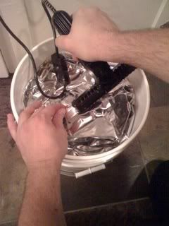

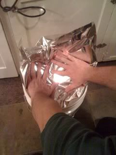

6) If using a Mylar liner, now is the time to seal it. Pull the bag top taunt and seal away.
Image Image
Make sure you squeeze the air or gas out of the top of it so it will all stow in the bucket. The way I accomplish this is seal 90% of the seal but leave an inch or two unsealed at one of the sides of the bag. Then fold/squish the bag into the bucket, pull out that unsealed corner and seal it. If you just seal it up without smooshing it down, it'll never fit in the bucket.
Make sure you check your seal to ensure it's a good one. If you have a lot of extra room at the top of the bag, seal it as near the top as possible. This makes the bag reusable later.

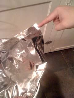

7) With scissors, make a little snip that'll let you open the bag later without a knife. Don't go too far and ruin your nice seal. I dare you to get one of these bags open with your bare hands.

- A 20"x30" or better sized bag will line a 5 or six gallon bucket.
