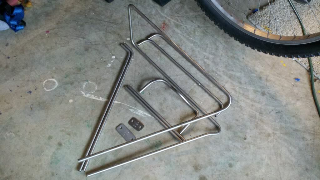

tonight I was able to get all the tubes bent and ready for welding in the morning. The frame has factory mounts for equipment already welded and machined on it win for me. Pics in the morning its time for bed.

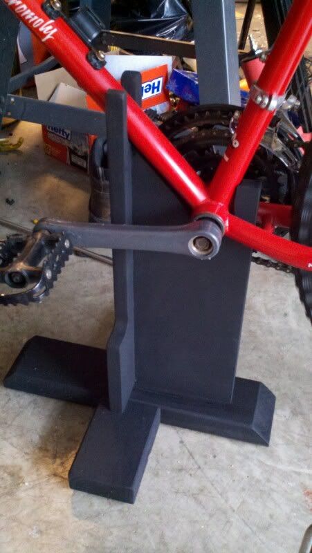

had to build a stand before I started the rack, I got the drawings from the next door niebor. Scrap lumber and some time equals free to me.
So all the tubes are bent and ready for welding just a little more fitting and I'll start the fab work.
Everything so far is free, best of all its all stainless steel but total weight is going to be around 3lbs. More updates soon ...

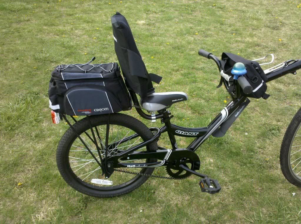

As someone else said, keep the dimensions of the top close to store bought racks, that way all the different aftermarket accessories will fit. There are all kids of bags and such that all seem to fit the "standard" sized rack.
I have racks on everything, started my son on a trailer bike (Giant Halfwheeler) around 4 years old and I added a handlebar bag and rear rack.
I had to make custom mounts to lower it down closer to the smaller tire
I found one of the old tandem Trail-A-Bikes on craigslist and mounted a rack on it too. I found an adjustable rack, it had two tubes on it that slid up or down the solid part and had three holes, but it was made for larger tires too so I cut the tubes shorter and drilled new holes to make it sit lower.

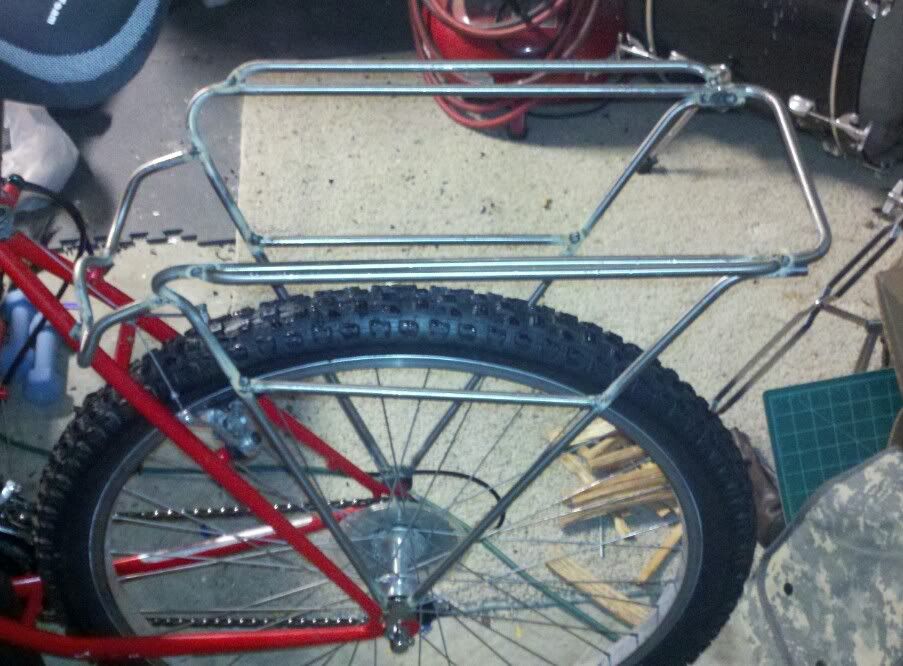

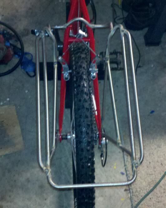

Postby Privateer73 » Sat Dec 24, 2011 5:26 pm
No lol thats just paint.
I have been looking at bags cases and panniers for several days now and really like a few I have seen just not the price. What can I say im cheap, I'll be using a sheet of rigid ABS for the deck plate so if at some time in the future I want to mount a trunk bag I can.
Looks like the horizontal braces are crooked but its just the camera angle.
Sorry for the poor quality pics its storming out.
I have to add pannier hooks and the deck then clean all the welds but overall I'm happy with it.

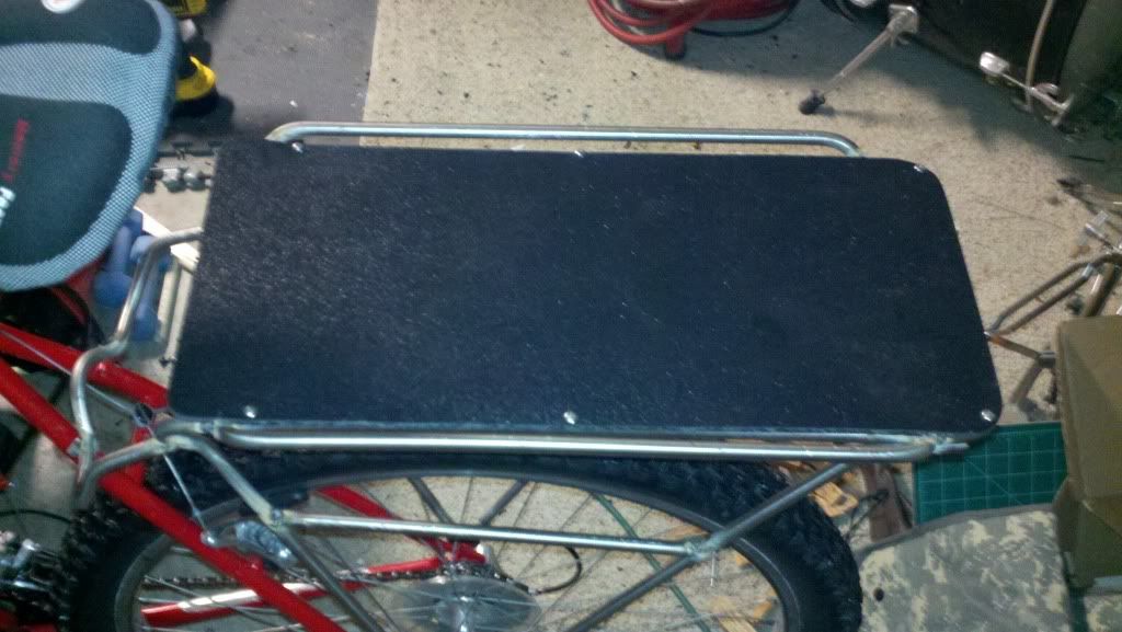

Postby Privateer73 » Sat Dec 24, 2011 6:13 pm
Deck cut and ready I have to add the rest of the screws later.

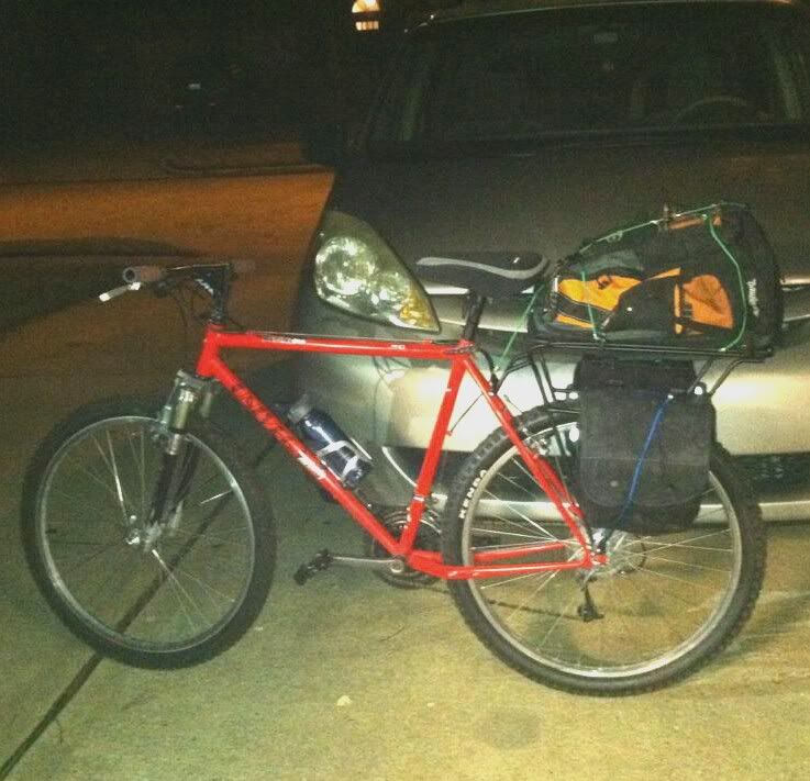

Postby Privateer73 » Mon Dec 26, 2011 11:04 pm
Well Im off to a good start I finished off the rack this morning and sprayed it with a coat of textured matte black. This evening I mounted it up hung the panniers and loaded it with nearly all my bob gear about 35lbs minus water and food. Everything felt solid and secure so I decided to give it a test run, the route I take when I exercise carrying my bob is just over 5 miles of concrete path and hard pack. I rode the same route but added a half mile or so by swinging by the corner store for some juice for the kids. I cannot be happier with the performance and there was almost no difference in handling besides the front being a little light. Next on the project a headlight and tiedowns for my bedroll on the bars.
Before I set out.
The finished rack.

Postby Privateer73 » Wed Dec 28, 2011 12:15 am
Thanks! I'll be using this during my WMBO entry 30+ miles round trip and probably around 36 hours out should be a good trial for me.
I picked up a bottle cage and better tie downs today still havent found anything in the way of a headlight I like yet. Now to trim the fat off my bob gear and get the weight down some.
