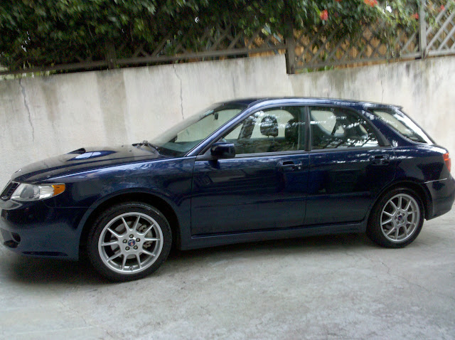

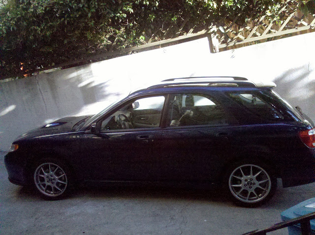

My wife's car is a station wagon that came without roof rails for a rack. The "other" version of the same car has roof rails that allow a rack to be installed. To be able to place a rack on top of the car to carry spare wheels, fuel, tools, etc in the event of an evac, we converted her car from non-roof-rails to roof-rails tonight.
Basically, we went from this:
To this:
Neither my pics nor our car, btw.
Doing this involved dropping the headliner. Which requires removing all the interior from the "waistline" up. Huge PITA as I hate car interiors, but whatever. The kicker? 9 months ago, we lined the roof with a contained layer damper covered with a mass loaded foam. The two were bonded with a super-whizz-bang adhesive.
