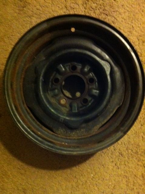

Here is that rim, cleaner than what's on it. It gets a sandblast, degrease and paint job this weekend and a fresh tire. Took me 6 months to find one under $100...

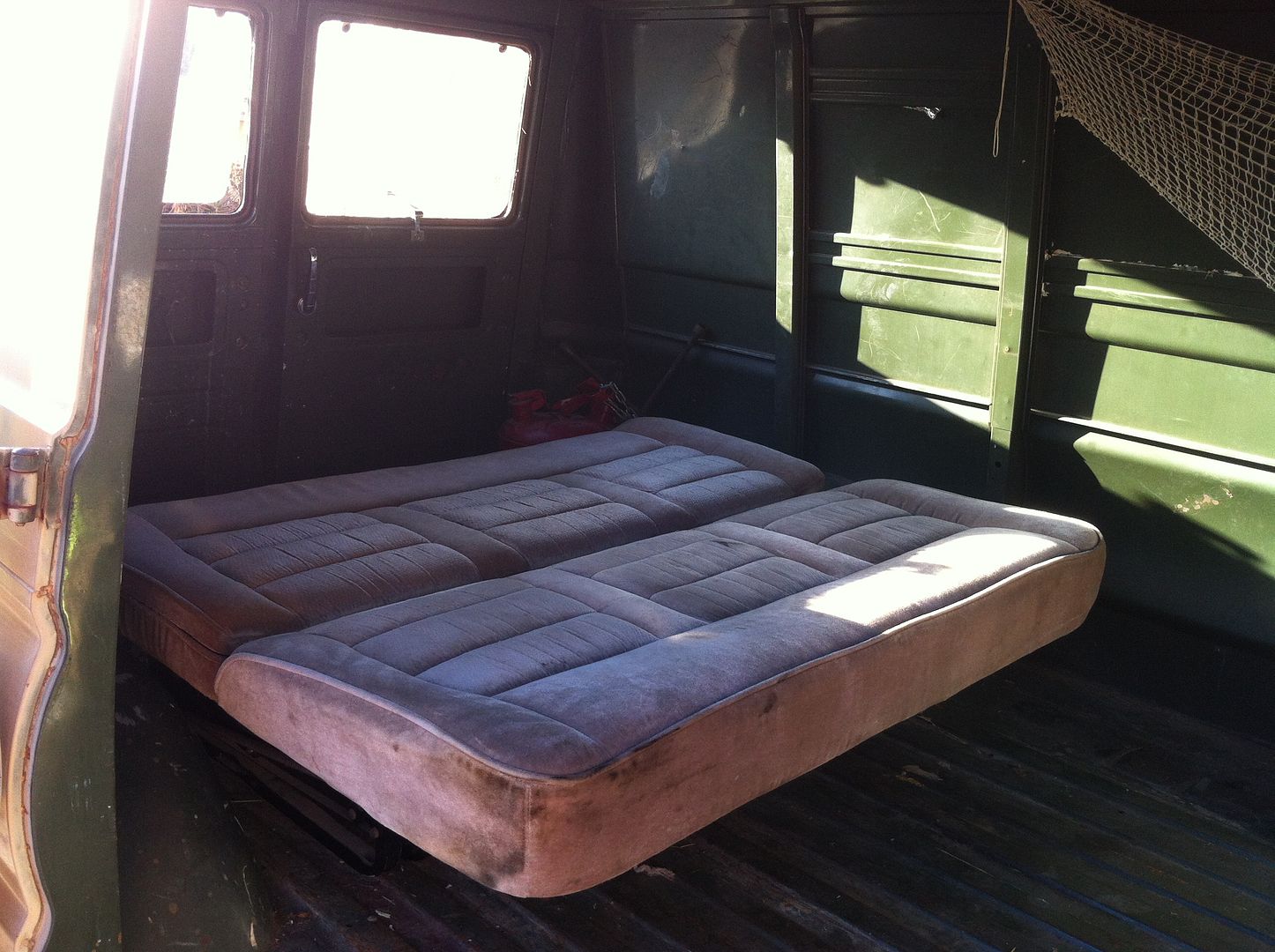

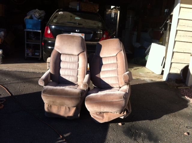

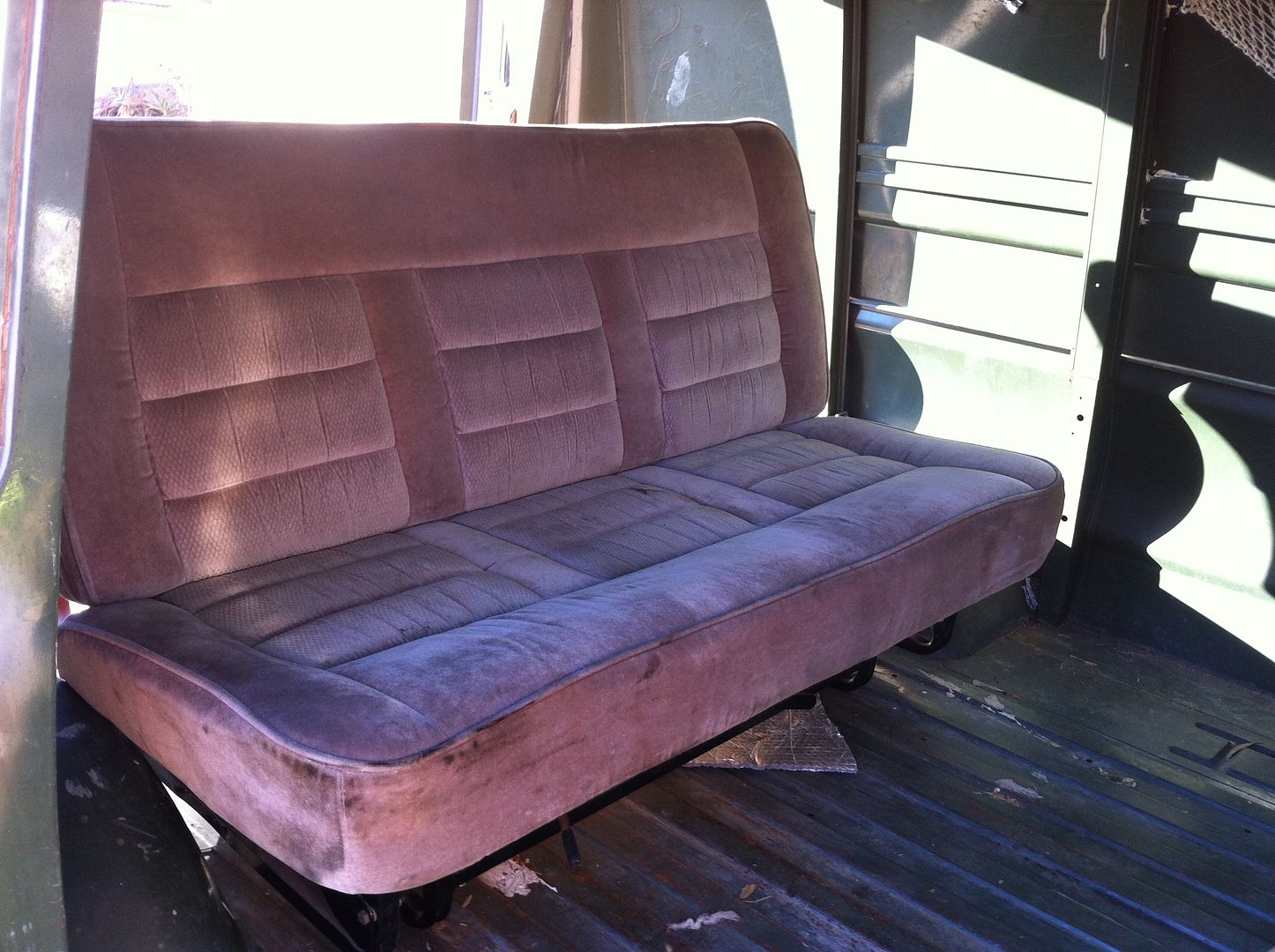

New seats from the Boneyard today. $60.00 including the belts. The Captains Chairs will come off the pedestals and go up front, and the Bench is a "Rock and Roll" and folds flat and slides forward on a track. I'm going to make a platform behind it for a full bed.

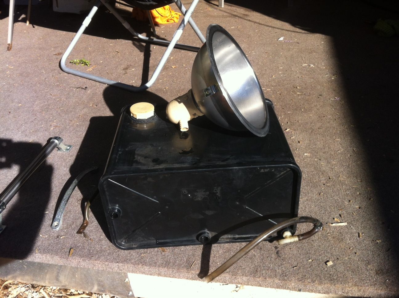

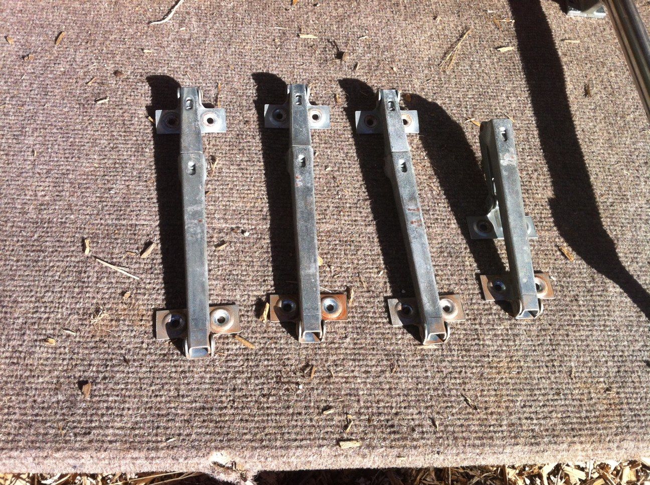

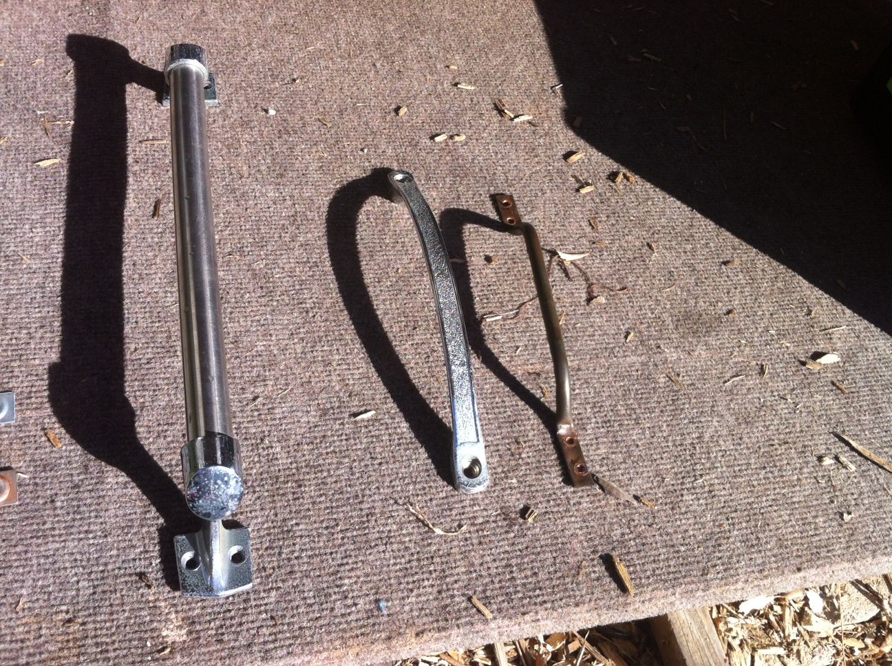

Got a bunch more stuff today. A 6 gallon water tank, a Stainless sink, 3 assorted "Oh Shit" handles, a set of 4 nifty folding table supports plus some assorted brackets. a set of sun visors that match the seats. Also a bunch of electrical parts, relays and switches and buss connectors as well as a whole bunch of 4gauge wire for the battery setup.
I think the plan is to build a small cabinet with some quick release latches on it to easily remove. Inside a Reliance "Baja" 2,5 gallon jug and the pump, and a Cat Litter jug for the grey water. Make the power cord long so I can use it in or out of the van, but right by the side door so you can wash hands while standing outside.

Today's project was to get the '64 vintage rim that will be my spare ready to have a tire put on it. First step was 3 days of Ospho baths I dr the work week, then today a heavy rinse, sanding, degreasing, and then two coats of primer. Let it sit in a nice warm spot and gave it it's first coat of gloss black.

So for the back seat Rock-n-Roll bed, I decided I needed to make it 2 inches higher to get it to clear the driver side rear wheel well. And to do that, I needed to make some steel extensions I can weld to the seat base.
I'm using 1" square tube I liberated from a pile in my dad's shop. Pretty sure this was from the roof rack of his 72 Titan MH, which went as far north as Fairbanks and the arctic circle back in 1980, as well as many trips all over the southwest and Baja.
So I stripped the paint and cut 4, 3" blocks and 2, 20" rails, and welded one together. This will also get welded to the bottom of the seat unit.
Needs a lot of cleanup, more later.

Finished up the Rock-n-Roll bed extension today. Welded it up, ground it smooth and primered it. Next is to Mack the backing plates for under the van floor and to paint this frame black and mount it.

Finished up the Rock~n~Roll bed install today. Of course I still have to fab the back half, but permanent seating is a done deal. All grade 8 hardware and galvanized steel backing plates.
Triple checking the mount locations
All the way back and upright
All the way back and down
All the way forward and down.
