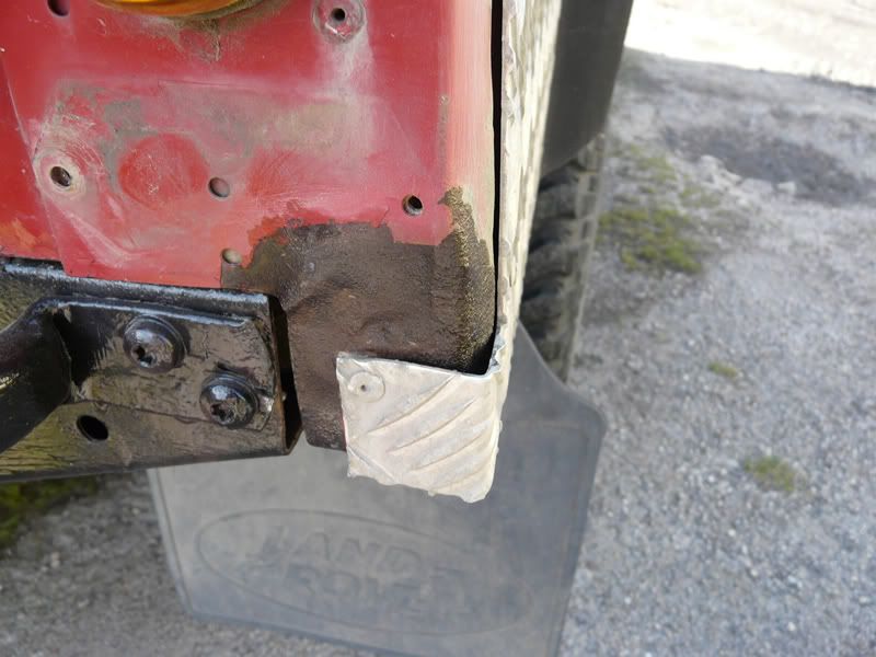

This is the worst area for rust that I can see clearly, I prepped it for painting:
There is another area of rust around the innside of the passenger door but that's tiny and even there it's not quite eaten through..

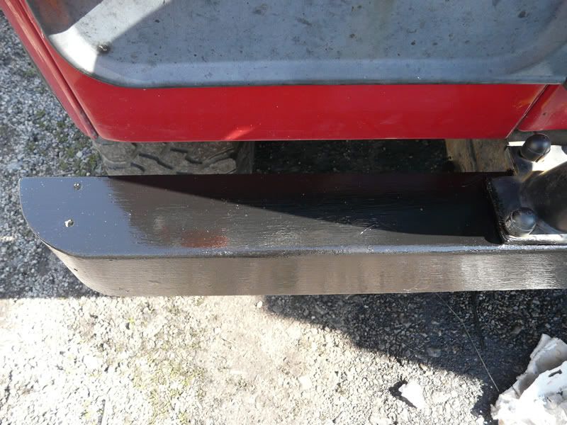

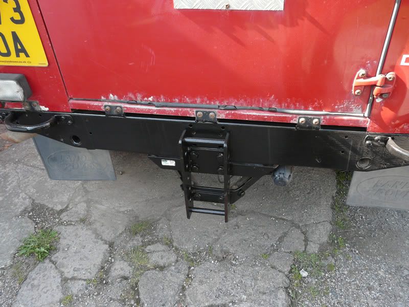

Back bumpers almost ready, just got to do some small awkward areas near the bodywork with a tiny brush:

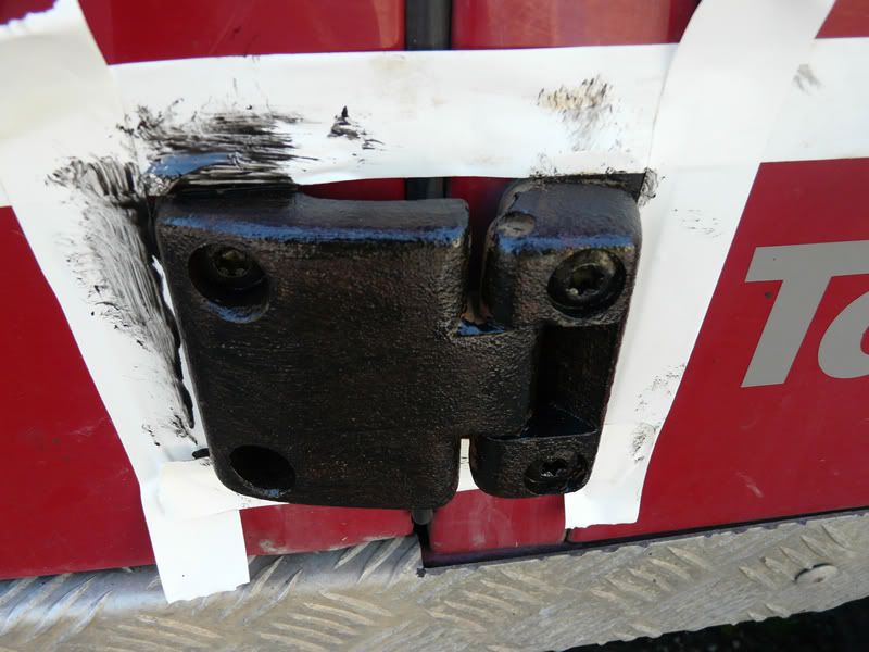

Hinges need one more coat and they'll be alright:

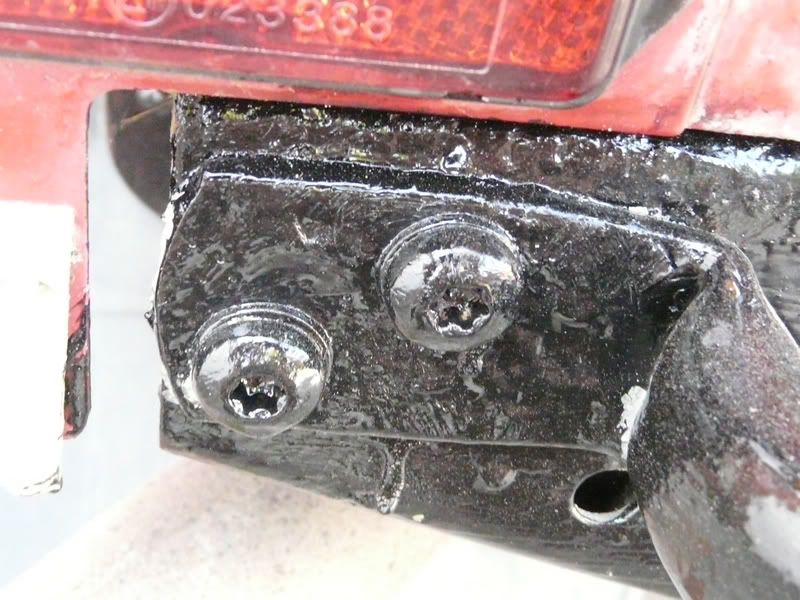

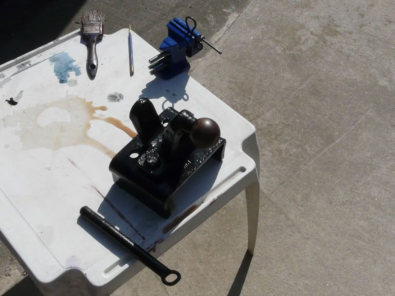

Tow assembly stripped down, note the split pins:
Tons of gunk fell down here once I'd finished digging it out, a messy job but it'll help keep the moisture and rust creep down:

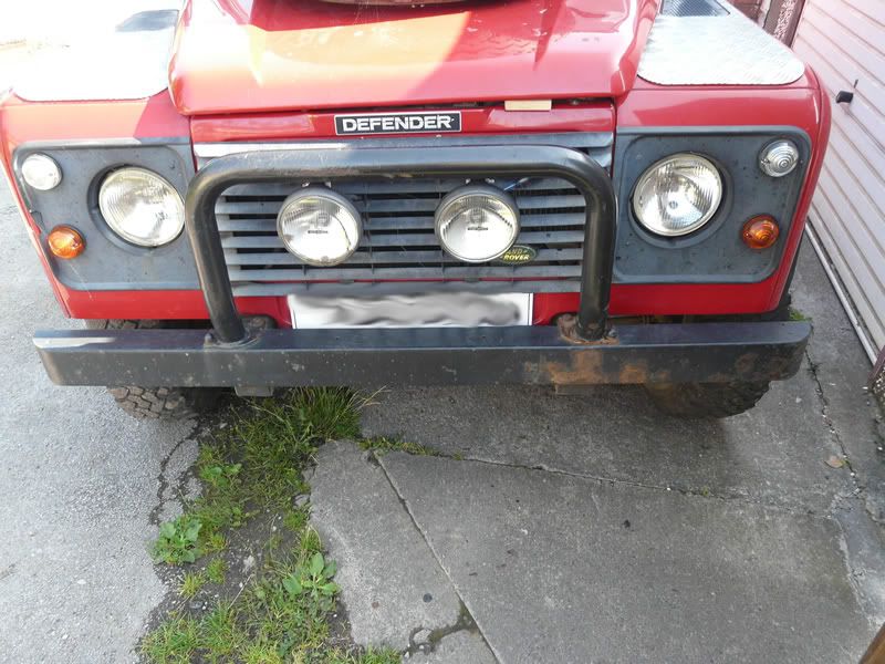

Lashed on the paint for its final coat on the front bumper:
I've really made it thick for standing on and shrugging off stone chips, scrapes and bangs:

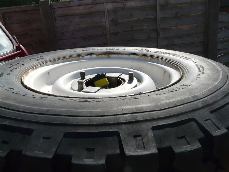

When you have a tyre mounted on the bonnet (or hood as you would call it) the remote release mechanism struggles. While at work though I found a tough looking carriage spring and welded it onto a plate. I bolted that in....
The spring splate wasn't ideal though; too many rings were on it and the main spring catch wasn’t engaging.
Out came garth’s grinder and it was not one, not two but three rings of the spring plate sheared off before the bonnet would close. The grinders disc went through the rings with ease despite being stainless.
Then the moment of truth. I pulled the release lever...
One resounding ‘klung’ later and it popped open!
I trimmed the release catch with some tin-snips and wrapped some tapeit. This prevented it from catching on the spring:

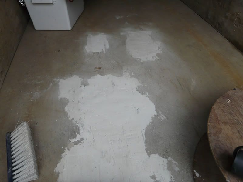

Got some filler down on the floor.

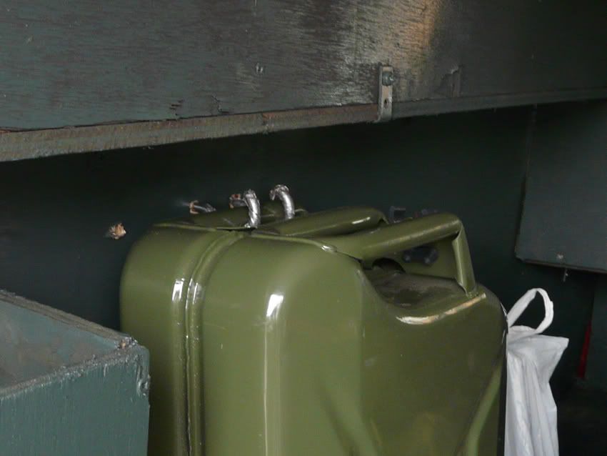

Jerrycans in place with some hooks to hold it steady. I had to cut these first down with a grinder...
Plenty of Water for an exped of week-end away somewhere. Note the solar reflector for keeping the sun off it (and prolonging it’s life).
