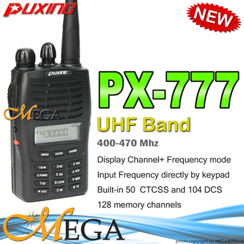

I have these radios for my company. We use them for surveillance. (I own a private investigation firm.) Other than the fact that I can't charge them in my BOB unless I buy a $200 or $300 solar charger. Are these any good? Any good in a BOB or INCH if I could afford the solar charger? Pluses and minuses? I like them because they are scrambled. And have 100 channels. 5w. Although I am not a radio guy. More of a scanner guy. Are these any good considering other options? I think they are Kenwood knock offs. Pretty good for the price. But please give me your honest opinions.
http://www.ebay.com/itm/Puxing-PX-777-U ... 19cdae7f04
Px-777 UHF 400-470Mhz
1. UHF
2. 400Mhz-470Mhz
3.UHF 4W output power
4.128 memory channels
5.Built-in 50 CTCSS and 104 DCS
6.Wide (25kHz) and Narrow(12.5kHz) channel spacing programmable in separate channels
7.Come with 1200mAh Li-ion battery
8.Input Frequency directly by keypad
9.VOX built-in
10.Frequency Scan & CTCSS Scan
11.Three different scan type: TO/CO/SE
12.Three color LCD backlight display
13.Sound Alarm
14.Programmable by PC software
16.Priority Scan Function
17.Adjust power High/Low
18.Switching between Channel/VFO
19.Display Channel+ Frequency mode.
20.Adjust squelch level (0-9)
21.Busy channel lockout
22.Keypad lock
23.Reverse Frequency Function
24.Channel step 5k,10k,6.25k,12.5k,25k
25.Program alphanumeric channels name
26.Self-program
TECHNICAL:
Frequency Range 136―174MHz,245-246MHz,400—470MHz
Working Temperate -20℃―+50℃
Operating Voltage DC 7.2V
Operate Mode Simplex or Semi-duplex
Dimension 100mm×55mm×32mm (Not included Antenna)
Weight 220g (Including battery)
Antenna impedance 50Ω
Transmitter
Frequency Stability ±2.5PPM
Output Power ≦5W
Max Frequency Deviation ≦5KHz
Audio Distortion ≦3%
Modulation Character +3dB—-3dB
Adjacent Channel Power ≥65dB
Spurious Radiation ≤7.5UW(-36db for CE)
Occupied Bandwidth ≤16KHz
Receiver
RF Sensitivity <0.2UV(12DB SINAD)
Audio Response +2dB—-10dB
Adjacent Channel Selectivity ≥60dB
Intermodulation Rejection ≥60dB
Blocking ≥80dB
www.legionarms.com
www.ultralightstove.com
(Email is: moduspi@gmail.com)

I think if you read through some of the past articles in this form you will seen the same threads over and over again. First the radio. Its a low cost Chinese radio. Not a bad radio for what it is, but is not as rugged as other commercial radios. As for good/bad for SHTF.... GOOD for what? What is your communications plans? Who do you need to talk to? How far do you need to talk? How many people need to talk. Its a fine radio if your distance requirements are less than 2 miles, but a junk radio if you need to talk further. Its a single band radio. There is NO frequency you can legally use this radio on that doesnt require a license.
Its capable GMRS, business band and ham bands but all need a license. Defined what your communications needs are then find the radio that fits that need.

The only thing "scrambled" on those radios is the claim that they're scrambled.

Good to know they aren't really scrambled. We practice radio security anyway. But still...
I should have mentioned my BO plan. My apologies. My needs are only to communicate with my group while traveling on foot. And these radios seem a large step up from an FRS or GMRS radio.
Do they make UHF radios in 5w that run on AA batteries? A solar charger to charge AA's is less than a $100. And I plan to carry one for all my other AA needs. It's only these radios that would require a much more expensive one.
Thank you so much for the critiques. I sincerely appreciate it.

In the call me in the woods situation your talking 4w vs 5watts or even 2w vs 4watts. YOu will never see a difference. Most of the radio state power output with a fix power supply and not the battery...
I would also note that the PX-777 UHF radio is NOT legal in the US. It has no FCC certification (at least none I have seen in the last few months. The PX-777 VHF radio does, but the UHF does not... WIth that knowledge these radio are ONLY legal on the ham bands.... Can you provide the FCC ID on it. Would love to hear the UHF is certified. SHould be on the radio typically behind the battery.

No FCC ID. Although I know we received a license from the place we bought them from. And continue to do so as far as I know. It was an issue when we bought these (many years ago) as I wanted to make sure we were doing everything legally. But someone else in my company handles this. We rarely use the radios though. Like I said, they sat for two or three years and no one used them. So the batteries died. I gave away all of them but two. We bought these locally. Not on ebay.

The dealer shouldn't be the one issuing licenses, it should be from the FCC. If it's a US-based dealer, they could get in trouble for selling those radios. Nevermind the kind of trouble if they're making their own licenses.
Now is it a real FCC license or just some certificate the dealer printed up themselves? You can find out by doing a search for your license here...

All good stuff rakk. The only dc adapter for the radios in the original post is one to use the radio off a cig lighter adapter. But no dc adapter is available for charging the batteries. I would have to carry an inverter. Therefore I think the FRS/GMRS AA radios would be the best answer for me. And the 5w solar panel with AA battery charger. All my headlamp, flashlight, radio, scanner etc. run off of AA. So it only makes sense that I run an AA type two way.
I didn't know the solar panels wouldn't work on top of a pack. That sucks. I guess stopping to charge batteries will be a requirement.
