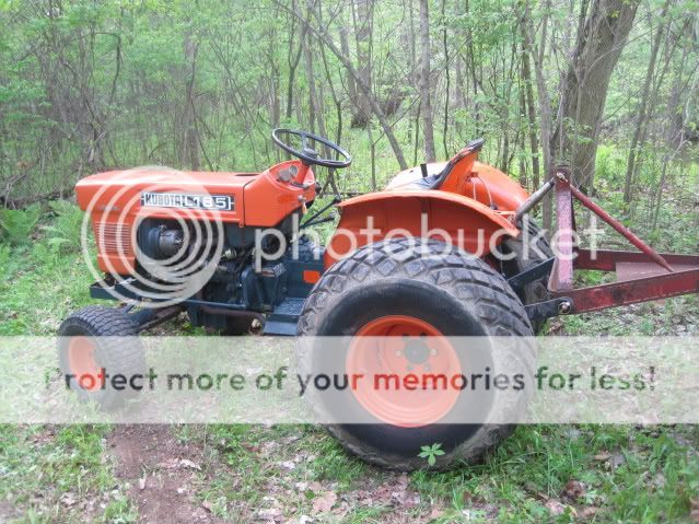

Here is Kubota 2200 hrs . Diesel with 3 point hitch . Bought it to help build log cabin and clear trails on my 7.5 acres of woods .Very simple machine . Been buying implements when I can find them for less then a hundred bucks or so .
Paid $2600 at auction . Only about 19 hp but a lot of power . 1977 thru 1980
