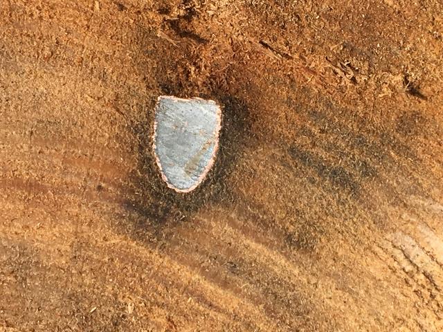

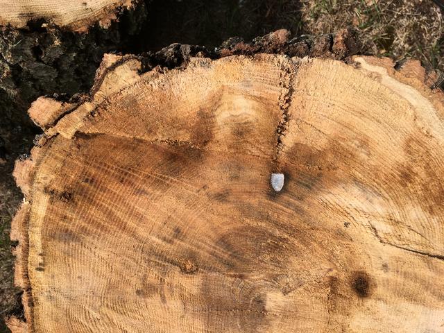

I've been using the files, keep saying I'll get something better/faster but haven't yet. Likely go with the table mounted one for the same reason you mentioned.
Coincidentally, was out just last weekend cutting up a good-sized oak when, wtf?, must have hit a knot I guess...
But not a knot.
Surprised it didn't break or at least throw the chain. Didn't even notice it until I was loading up the logs into the truck. What's the odds?
Edited out a 'duh' statement lol.
But not a knot.

Re: Electric Chainsaw Sharpener
Soft copper and lead. Not much there to really bother a chain. Nice slice to save and use for something, maybe make a clock from.
that's exactly what I was thinking. Cut like 3" or so thick slab. That's one hell of a find!
Interesting how far it penetrated too. Looks to be maybe a 9mm with that flat base, but I wouldn't expect such deep penetration into oak by a 9mm. Especially with no visible deformation. Make this part of a bar top or bar decor and many beers would be spent contemplating the circumstances that got it there.
I thought the exact same thing. I am about 99% sure it's 9mm, and about 5" or so in. I've shot through 4x4's but those aren't oak. and you're right, that isn't deformed at all. Hell, I'd let that sit, and cure slowly, then put a nice finish on it and hang it just like that. That would be one hell of a convo piece.NT2C wrote: ↑Thu Aug 02, 2018 5:29 pmInteresting how far it penetrated too. Looks to be maybe a 9mm with that flat base, but I wouldn't expect such deep penetration into oak by a 9mm. Especially with no visible deformation. Make this part of a bar top or bar decor and many beers would be spent contemplating the circumstances that got it there.
They aren't 4" either.
