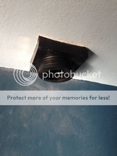

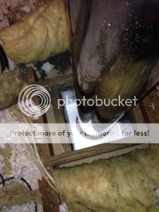

Framing the support box was pretty simple. My cuts weren't great so I used high temp silicone to seal any gaps so that debris can't get near the support box.
The hard part was leveling the support box inside the framing (took 2 people and a few trys). My advice is not to settle for less than exactly level because this is the key to make cutting the roof hole correctly.
This picture is before I put the attic insulation shield in place.
And after

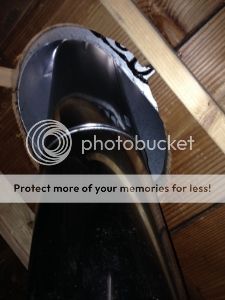

My support box wasn't perfectly level and my roof hole cut was pretty bad as a result. You can see the tar on the underside of the chimney flashing as an example of the excess cut. It took 3 saws all blades because the roofing material dulled them pretty quick.
A trick I learned that is helpful for cutting the roof hole that I had not seen on the net is to first put a section of the pipe on the support box so that it is close to the roof. Then attach a sharpie to a level (a fairly long one) that is 2 inches thick and put it against the chimney section with the sharpie side out and slide the level up marking the roof on 4 sides of the pipe (this makes marks 2 inches away from where the chimney passes through the roof). Finally, screw 4 long screws up through the roof where your marks are, go onto the roof with some chalk and either draw a circle or put the flashing down using the screws as reference points to trace inside.

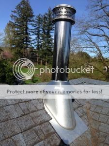

After sliding the storm collar down over a bead of silicone I put another bead around the top and on the collars buckle.
I'm not sure how long that Blackjack stuff takes to dry but it's messy as hell (next time I'll use latex gloves). Still need to build the platform for the stove but the roof was what I was stressed about.

Post by DarkAxel » Fri Apr 11, 2014 12:51 am
That looks pretty good. Looks like you got everything lapped properly.
That Wet-R-Dri/Blackjack (roofing sealant) takes quite some time to dry. It's made to get soft and sticky when the sun warms up the roof. If it dries out too much (around 5-10 years or so) it will begin to crack and break loose (letting in water). It's made from petroleum, so it will weaken and tear latex gloves. I usually use those cheap $1 gloves you can buy at the local gas station and wash off the seep-through with acetone or Zippo Fluid. I usually use a rag soaked in a bit of gas or kerosene to smooth down a bead.
