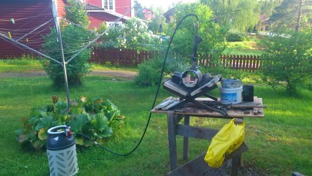

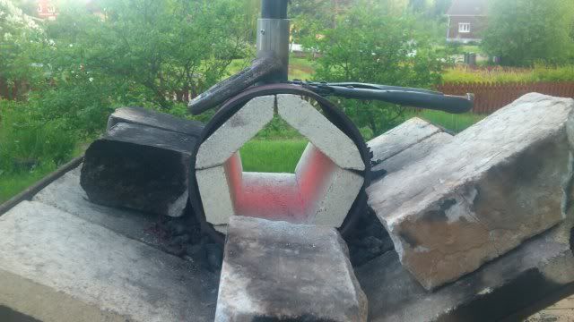

Range report
This is a first prototype of the forge assembly:
The parts are just kludged together here. The forge is propped up on my old coal forge and the burner is held in place with a C-clamp and a welding clamp. I mostly just wanted to se if the burner worked properly and if my idea for a forge was workable.
The forge itself
When finished the forge will be lined with firebricks, the bottom three are in place here and the two top ones are lying on the table to the left of the forge. They fit but I haven't cut the hole for the burner in the top bricks yet.
Notice the clamps holding the burner. I clamped a welding clamp to the forge wich in turn holds the burner. I actually think I will use something like this in the end but with the clamp welded to a proper stand instead of the C-clamp used here. The burner is held very securely and it's very easy to disassemble. Ignore the bracket held by the hose clamp, that idea got scrapped.

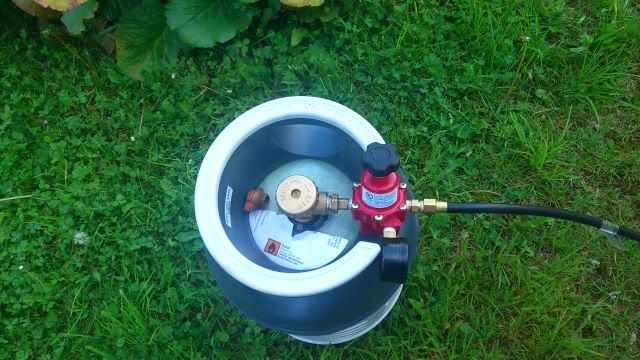

Unexpected problem
The regulator was a ridiculously close fit on the propane bottle. It worked but the clearance is only a couple of millimetres. This puts the pressure gauge at a rather awkward angle and I will have to adress this issue at some point.
Money Shot
This turned into a very pretty little knife. It just needs some filework and heat treating.

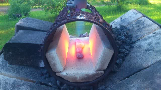

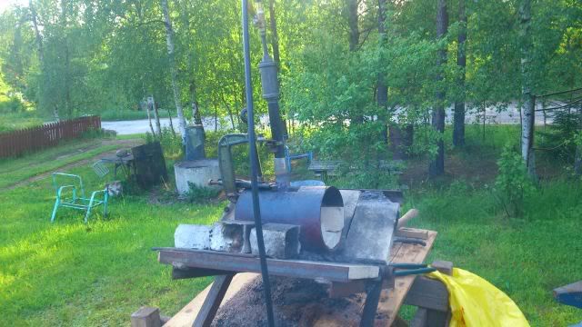

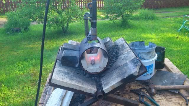

The forge itself is done. The lining is in place and it works well.
I still have to make a stand to hold the burner properly.

Looks awesome! Any plans to enclose one side to allow higher heat? Even leaning a fire brick on it, perhaps? That should allow easy removal for longer stock, but still give you great heat and efficiency for smaller pieces if I'm remembering my research correctly.
- Posts: 953
- Joined: Wed Oct 24, 2007 1:32 pm
- Favorite Zombie Movies: 28 Days Later, Resident Evil
- Location: Bureaucratic people's republic of Sweden
Re: Re: Propane forge. PROJECT THREAD *Update - pics and stu
There is a problem with doing that. It directs too much heat out the front of the forge, I tried and it set fire to the glove I was wearing when I tried to remove the thing I was working on. I actually put a brick in front of the forge that sticks up about 3/4'' above the floor of the forge to direct more heat out the back.congochris wrote:Looks awesome! Any plans to enclose one side to allow higher heat? Even leaning a fire brick on it, perhaps? That should allow easy removal for longer stock, but still give you great heat and efficiency for smaller pieces if I'm remembering my research correctly.
Had the forge been larger it might have made a difference but as it is now, the burner is running nowhere near it's full capacity. I haven't even tried cranking the burner up to full speed. It's supposed to run from 3 to 30 psi, at 5psi it's hot enough to work smaller pieces of steel. At 10psi. it heats up large pieces of steel in minutes. When increased to 20 I half expected lift-off.
At 10psi it's impossible to have anything flammable within a foot or so of the opening for more than seconds. I have to construct some kind of heat shield or I'm going to run out of gloves soon. It also heats up the workpiece much higher up than I want. I have some stainless steel plates lying around that should do nicely.
