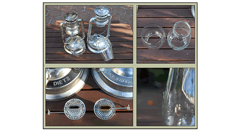

I saved the globe shape for last. Differences in fount size, wick, and finish are all pretty much easily explained, but the differences between and the reasons for the tall and short globes are not so obvious. It's the one thing that really sets one lantern apart from another visually. I read that the tall teardrop-shaped globe is the earlier of the two, and that the short round globe came later.
The two lanterns that I have happen to be very similar, with the exception of the globe, so it seemed fitting to compare them. In the image above, on the left is the Dietz No.90 "D-Lite", with its short round globe. The D-Lite appeared around 1919, and was the progeny of prior Dietz models and those of another lantern maker which Dietz absorbed in 1914. On the right is the W.T.Kirkman No.2 "Champion" lantern, which resembles the Dietz No.80 "Blizzard." It has the taller teardrop-shaped globe, which dates back to the 19th century. Next - dual throw-downs: Tall globe vs. short globe, and Dietz vs. Kirkman.
Tall Globe vs. Short Globe
The short globe lantern has two distinct benefits. It is shorter overall and requires less storage space. The round globe is very easy to clean, owing to the larger openings on the ends. I also think that the short globe lantern is more attractive. In addition to the round globe, I really love the look of the tin plate vs. the galvanizing. (Whether tin or zinc, each finish is historically accurate for its lantern.)
The tall globe has advantages also. Most importantly, it burns brighter. The draft created in the tall globe lantern stretches the flame higher, and the result is a bit more light. See?
I have read that the tall globe is preferred at altitudes over 5000' because of the greater draft it produces. Inevitably soot is occasionally produced by both lanterns. In the tall globe, it will accumulate first up high in the globe, away from the flame, which doesn't reduce the light output of the lantern as much as with the round globe, wherein any soot that is created decreases the output. It's also easier to get the globe out of the Champion. With the D-Lite, when the chimney is raised to remove the globe, there's barely enough room to tilt the globe out. The glass worrisomely grinds against the chimney just slightly. When removing the tall globe there is no issue at all.

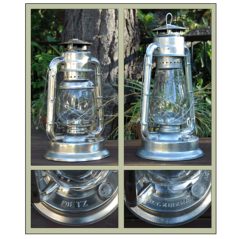

Dietz vs. W.T. Kirkman - or - Will LanternNet get its money's worth:
There are several features of the Champion which distinguish it from any of Dietz's modern offerings.
The finish: AFAIK, W.T.Kirkman is the only manufacturer currently galvanizing their lanterns. The huge majority of Dietz lanterns are painted. The tin plating on my D-Lite is a rarity, and it's very attractive, but as tin is higher in the galvanic series than zinc, the tin doesn't provide as much corrosion resistance - barely more than the common steel beneath it - and after just a few months the tin plated lantern is already showing the first signs of corrosion. I've had to give it a prophylactic coating of Boeshield T-9.
The Loc-Nob globe: In 1915 Dietz began to manufacture "Loc-Nob" globes, which were held into the globe frame by means of ears or tabs protruding from the glass. Modern versions of the lantern have thinner, less expensive, less authentic globes that lack this feature, but Kirkman manufactures their own globes in the old way. In addition to the loc-nob feature, the glass is thicker and more robust.
Above, upper left: the two lanterns with their globes tilted out. This is how the lantern would look for globe cleaning or wick trimming. Upper right: The Dietz short globe is easier to clean. The Kirkman Loc-Nob globe is as thick as a mason jar. Lower right: the knob can be seen protruding from the edge of the Kirkman globe. It helps prevent the globe from accidentally slipping out of the globe cage. Lower left: the Dietz and Kirkman burners side-by-side. Almost identical, but not quite.

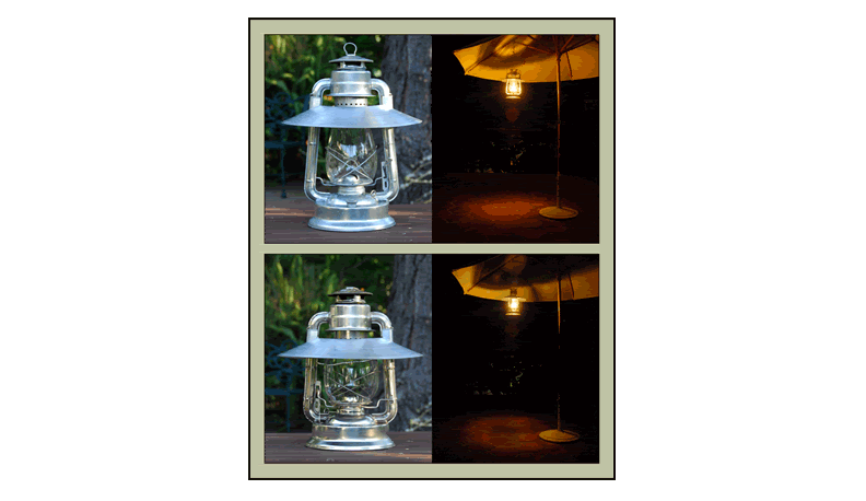

The reflector hood: Whether or not this was once an accessory offered by Dietz I cannot say. The hooded reflector that W.T. Kirkman offers is well made and has the same galvanized finish as their lanterns. It's more expensive than a lantern (because it's hand made in the U.S., while the lanterns are made offshore, I think) but worthwhile in two circumstances: if you want to light a table or workbench, putting the hooded reflector on your lantern will direct a portion of the light downward, removing the shadow cast by the fount. I bought the reflector to use on the D-Lite when I originally purchased it. It fits well, but the reflector casts a much more even light downward when mounted on the Champion, for which it was designed. The reflector is also a blessing when you set the lantern on the surface that you are working on or eating off of. It shields your eyes from the direct flame of the lantern and protects your night vision a little bit.
Here is the reflector, seen on both lanterns. While it fits both of them, notice in the photos on the right that the pool of light cast below the lantern is brighter and more even in the case of the Champion.
Metal thickness: I can't remember if it was in one of Woody's emails or on the website, but I remember a claim that the Champion is made of stouter sheet metal than modern Dietz lanterns. Well, I wasn't going to let that one just fly by unassailed. So I broke out the micrometer and got busy. There aren't many places on the lanterns that one can wrap a micrometer around. I could have band-sawed the lanterns apart, and that would have given me many more measurable spots. I like you guys, but not that much. Not all of the Champion is made of stouter stuff than the D-Lite, but I can tell you that the chimney is.
The filler cap: easier to replace on the Dietz. A bit fiddly on the W.T. Kirkman.
