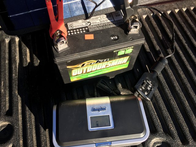

This was the first "solution", 15 watt solar panel -> small lead acid battery -> cigarette lighter voltage adapter -> battery charger (which normally uses a 110 vac wallwart to convert it to 12v dc).
It works too, as long as you don't drain the battery too deeply. I like the jump starter better since it lives in the truck and charges automatically off the alternator.

Re: Charging Eneloop AA through USB
I wouldn't. Small UPSes (those that don't require forklifts to move) would be pretty shit at the job. They're designed to only occasionally have to actually charge the batteries, so their charging efficiency is low (in order to keep the size and cost of their circuitry reasonable, and temperatures down).quazi wrote: ↑Fri Sep 11, 2020 8:15 pmI think I must have missed something, how are the UPSes going to get recharged if I've already drained them powering stuff after the power has gone out?boskone wrote: ↑Fri Sep 11, 2020 8:01 pmIn those conditions, I think you'd be better off just letting the UPSes stay charged, and plug a regular battery charger into 'em. If you really want a USB charger for connecting to the solar panel or such as well, I'd just put a wall-wart on the UPS to connect it to.quazi wrote: ↑Fri Sep 11, 2020 7:48 pmJust to clarify, what I have is a good amount of rechargeable AAs and a couple things that can provide a very meager amount of power through USB until they break (a small solar panel and a hand crank radio). What I'm looking for is an inexpensive way to recharge the AAs using the solar panel or radio. The lead acid battery would just be an in-between.
I do realize that the batteries would take an awfully long time to charge. This is more of a long-term last resort thing and not something I'm intending to do during a normal power outage (I've got enough charged batteries to get me through those). I am going to get a more serious off-grid setup some day, but not right now.
That'd let the SLA batteries stay charged, and give you probably the overall most flexible method of power-delivery from them.
I'd use them as a power reserve, because you already own 'em; basically zero up-front cost.
But if I wanted to recharge the batteries during a disaster, just about anything would be a better option. A battery monitor, for instance, is going to have a lot more volume dedicated to it's circuitry, and won't be concerned with a bit of heat. It'll probably be way more efficient.
A home battery bank (or at least the controller) is a bit different, because it's rather larger than the circuitry in a small UPS. It's more akin to a building UPS, which can afford to have more space for the circuits than the full volume of the small UPS; that's plenty of room for cooling and high-efficiency doodads.
In your case I'd just use the UPSes to keep the batteries topped off, and use them as secondary power stores; I wouldn't even bother trying to actually charge them until utility comes back up (or I got a generator to plug 'em into).
Is that the same thing Ebuff75 linked? It looked great to put in a BOB. The reports of things melting were a little concerning, but maybe they have that fixed now.
I'd be down to just use the UPSes as a small, temporary power reserve.boskone wrote: ↑Fri Sep 11, 2020 9:22 pmI wouldn't. Small UPSes (those that don't require forklifts to move) would be pretty shit at the job. They're designed to only occasionally have to actually charge the batteries, so their charging efficiency is low (in order to keep the size and cost of their circuitry reasonable, and temperatures down).
What I'm wondering is if there is a cheap way to keep my AA batteries charged up through USB if I had to, specifically using devices that would not generate much power. I've got a few USB battery chargers that people linked earlier, but it was mentioned that trickle charging them might not be good for them.
If you buy Eneloops, Tenergy, or other low self discharge (LSD) cells, I wouldn't worry too much about keeping them topped up. I think Eneloops are supposed to stay above 90% charge for a year or two, so if you cycle your batteries through normal use you'll probably be fine.quazi wrote: ↑Mon Sep 14, 2020 8:50 pmI'd be down to just use the UPSes as a small, temporary power reserve.
If you want, you could drop a few bucks on a higher end charger/exerciser, and run the batteries through that instead of just charging. That would also let you check the health of each battery as it gets charged.
