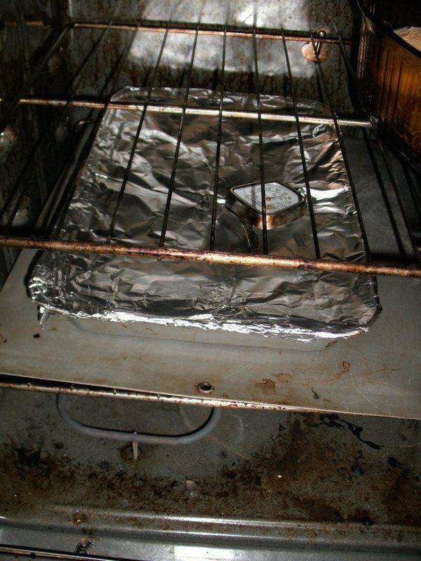

One thing I can add for tempering in a home oven is that you want to use a muffle of some type.
Why?
The On/Off cycles of the oven actually raise the oven temperature considerably higher than the set temperature and taking into consideration that the knife edge, the most critical part of a good knife, is the thinnest, it will be the first area to be affected by the higher heat and thus lower the hardness of that area first. I ran a couple of tests with a muffle using electronic temperature probes inside the muffle and another probe just in the oven at the height of the rack. to put it simply, the temperature just inside the oven varied widely and the temperature inside the muffle was very steady.
for a single blade, a muffle could be as simple as loosely wrapping the knife in aluminum foil to get a minimum of 2 layers up to 3 layers, if you are doing many knives, a half inch of play sand in the bottom of a baking sheet and another half inch of sand on top of the blades will also work. For clarity, the 2 - 3 layers of aluminum foil wrapping, when I say 'loosely wrapped' means roughly 3/4" - 1" of thickness/radius around the blade. Because I was making a lot of blades, I made a custom muffle that was basically a very large cookie sheet bottom, a piece of chicken wire wrapped in aluminum foil - 2 layers on each side, lay that in the cookie sheet and place knives on that and cover with basically the same setup as the bottom.
Here's a graphic of the data from the tempering temperatures inside and outside the muffle: This oven was set at 375F. So without a muffle and a temperature probe, you can only make a likely very inaccurate guess as to the hardness attained after tempering.
You can pick up a multimeter with temperature probe for under $20.00.
I personally recommend a single temper for 3 hours using a muffle rather than 3 tempers for 1 hour without a baffle. Your knives will love you and you will love them. Using a muffle requires longer temper as it takes roughly an hour or more for heavy blades for the whole blade to come up to temperature.

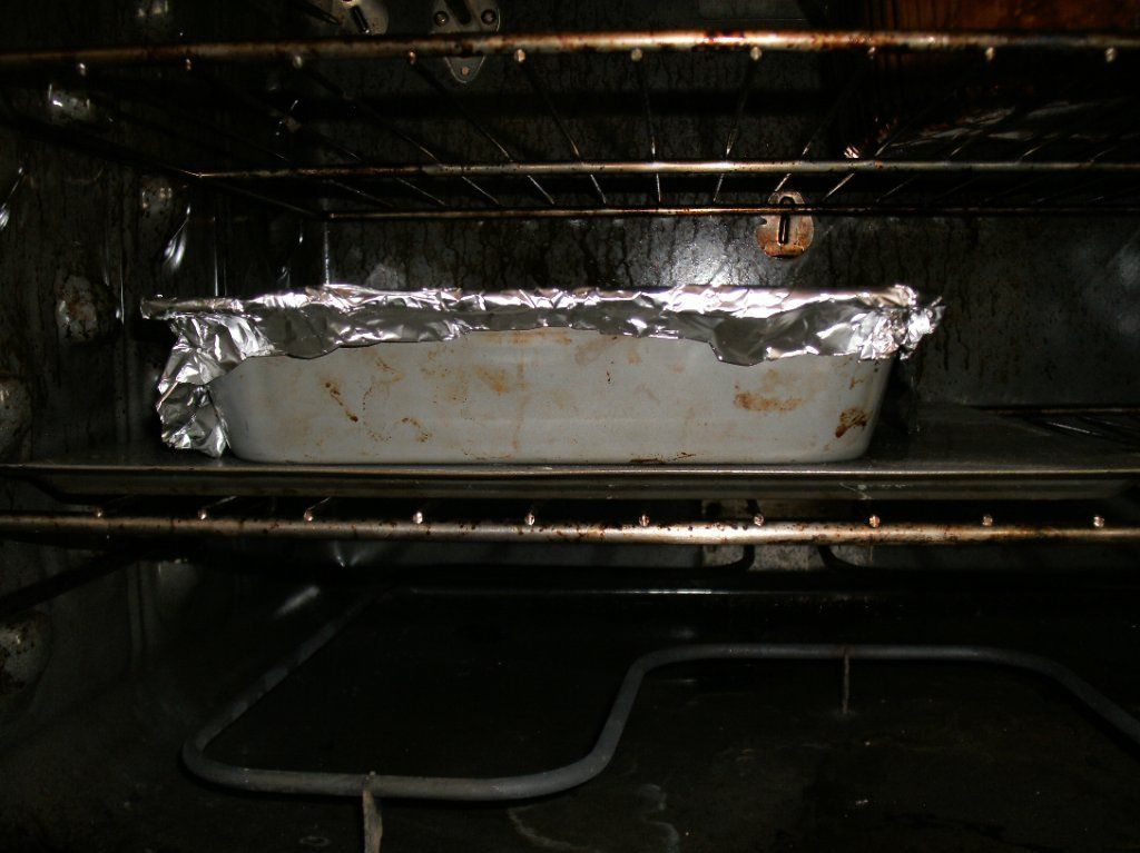

I found a couple pictures of my original incarnation of the oven tempering muffle from 2009.
It is pretty basic, an air cushioned cookie sheet on the bottom (a cookie sheet that is double layered with an air pocket between the two layers) this could be sumulated by placing a layer of aluminum foil across the rack and turning a regular cookie sheet upside down. Then a cake pan that holds the knives, a crumpled layer of aluminum on the bottom of the pan and a crumpled layer on top of the knives and a layer of aluminum foil covering the cake pan. This is the setup that I took the temperature measurements with.
