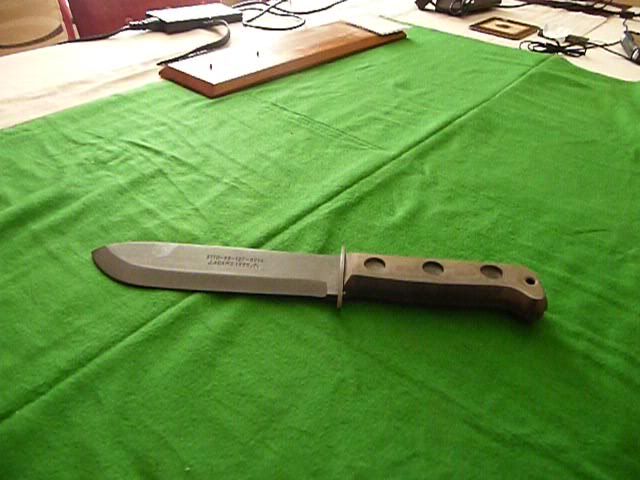

Here she is, a J. Adams Survival knife.
I've owned it for many years now and it's time to have a review buzzing about YT...
Video Review
http://www.youtube.com/watch?v=3lUDKQeparU
Blade length is 7 inches and it weighs just over 1lb
Kyle Ryder

Postby Dominion » Fri Aug 27, 2010 9:18 am
Looks like a very tough blade...
Scandi grind?

Postby Kyle Ryder » Fri Aug 27, 2010 12:10 pm
Scrap hound has it!
It's a British Army Survival Knife and still has the issue number on it :)

Postby Dominion » Fri Aug 27, 2010 3:41 pm
My ambiguous (Scandi Grind?), was in reference to the edge. Does the edge have a secondary bevel, or is it simply a saber grind to the edge, without a secondary bevel?
What is the thickness of the blade?
Nice knife! Prior to this I'd never seen nor heard of one. Thanks for the review!
Dom.

Postby Jeriah » Fri Aug 27, 2010 3:52 pm
Dominion wrote:My ambiguous (Scandi Grind?), was in reference to the edge. Does the edge have a secondary bevel, or is it simply a saber grind to the edge, without a secondary bevel?
Dom.
Since the blade appears blued or Parkerized, if the grind goes all the way to the edge, doesn't that mean you'd have to put a secondary bevel on it when you sharpen it, unless you want to wear all the finish off the primary (only) bevel maintaining the scandi grind? For this reason I assume it's got a secondary bevel already, since there's little point in putting a Scandi grind you're not going to be able to preserve.

Postby Dominion » Fri Aug 27, 2010 5:12 pm
Dom.
Similar to my thoughts and the root of my question. In the vid review, a closeup of the blade is given. While looking as close as possible, I was not able to see a secondary bevel... thus the question was born.
He did say it was some sort of stainless, so it may not need as much protecting. In this application, the coating actually more likely for anti-reflection. Even so, this is an unusual application for a scandi grind, if indeed it is, for the reason you mentioned above.
Dom.

Postby cowboyfromhel86 » Fri Aug 27, 2010 5:22 pm
http://www.flickr.com/photos/bdt/420852179/
it has a sec grind
I really find it hard to believe its stainless... I dont see why it would have to be blued if it was SS and he did say it rusts pretty easy.. but I know nothing so I could be wrong but I will tell you that I think this knife is bad ass

Postby Dominion » Fri Aug 27, 2010 5:29 pm
Ah, can definitely see the edge on that one.
If you look on Kyle's vid review at 4:23, it's difficult to see.

Postby zoiders » Fri Aug 27, 2010 8:54 pm
I know that knife it's an MOD survival knife commonly on aircrew issue.
http://www.sheffieldknives.co.uk/acatal ... nives.html
Good quality carbon tool steel with a heavy duty baked on coating just like a service rifle so an armourer can re-coat it if needed, they are a full 1/4" thick.
They are flat ground on the bevel with a second grind on the edge, it doesn't need or want to be stainless.
I am not sure why some boutique knives like a RAT cost so much in comparsion, you can pick an MOD knife up for about £35-40.
It's a beast, you could batton with that thing using a sledge hammer.
An intersting knife is the IDF Knife lower down which is like a SOG knife for about half the price and probably the same build quality if it's a sheffield job

Postby Kyle Ryder » Sat Aug 28, 2010 3:39 am
Dom.
I'm just going out the door but off the top of my head from memory (it's back in it's drawer) about 1/4 inch...
Thanks for the responses.
You could cut through thin aluminium with this thing btw as it's got good weight behind it.
I may of been wrong when I said stainless steel, this is due to the finish on it and going off memory of the other knife like this one I saw 12 years ago it may of been carbon...

Postby Chef » Sat Aug 28, 2010 2:05 pm
Pretty cool knife, especially for the price. My only quibbles are the guard, which would get in the way of certain tasks, and the bluntness of the tip, I'd prefer something slightly pointier (but not much). Those rivets are sexeh.
What's the sheath like?
