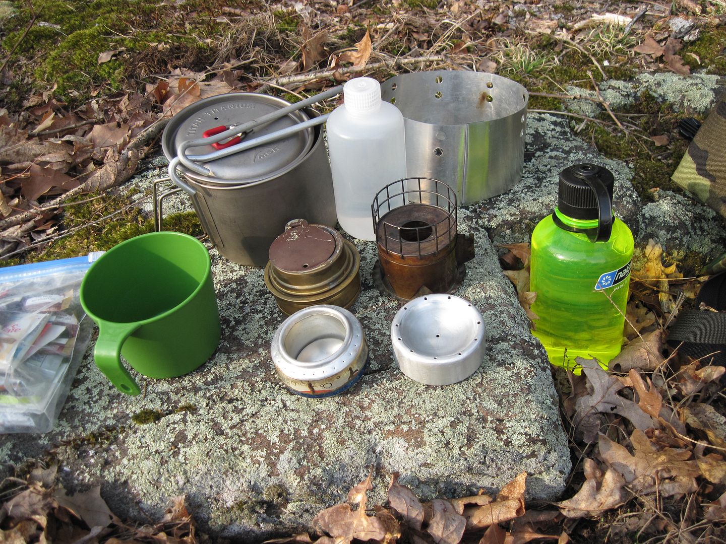

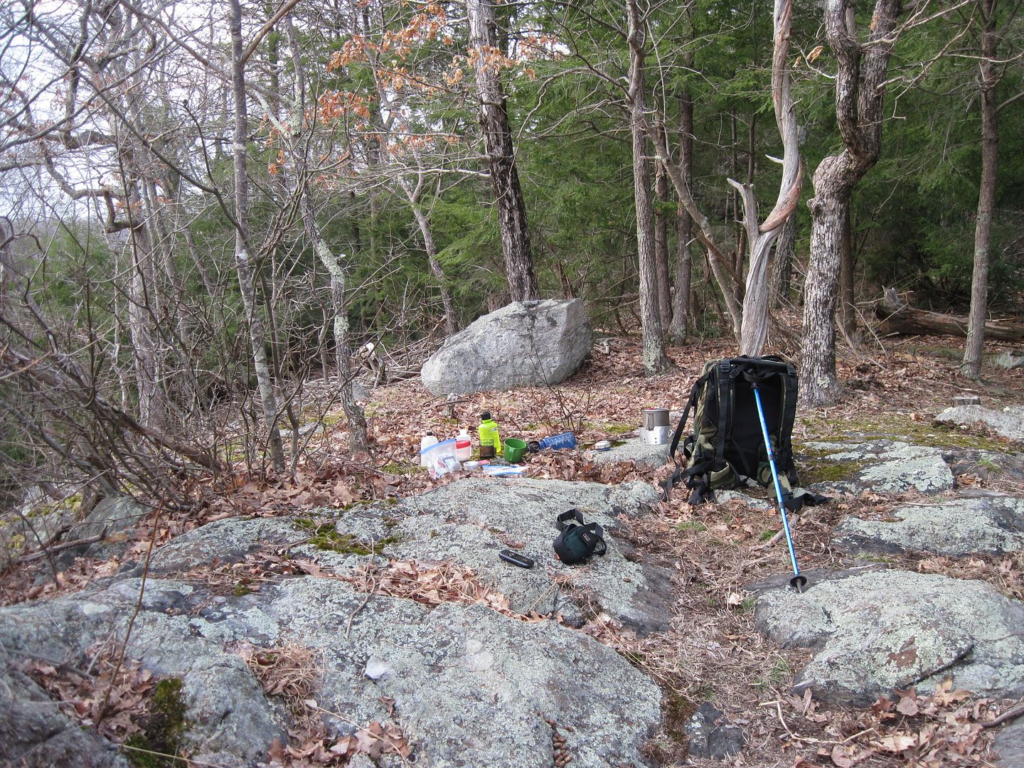

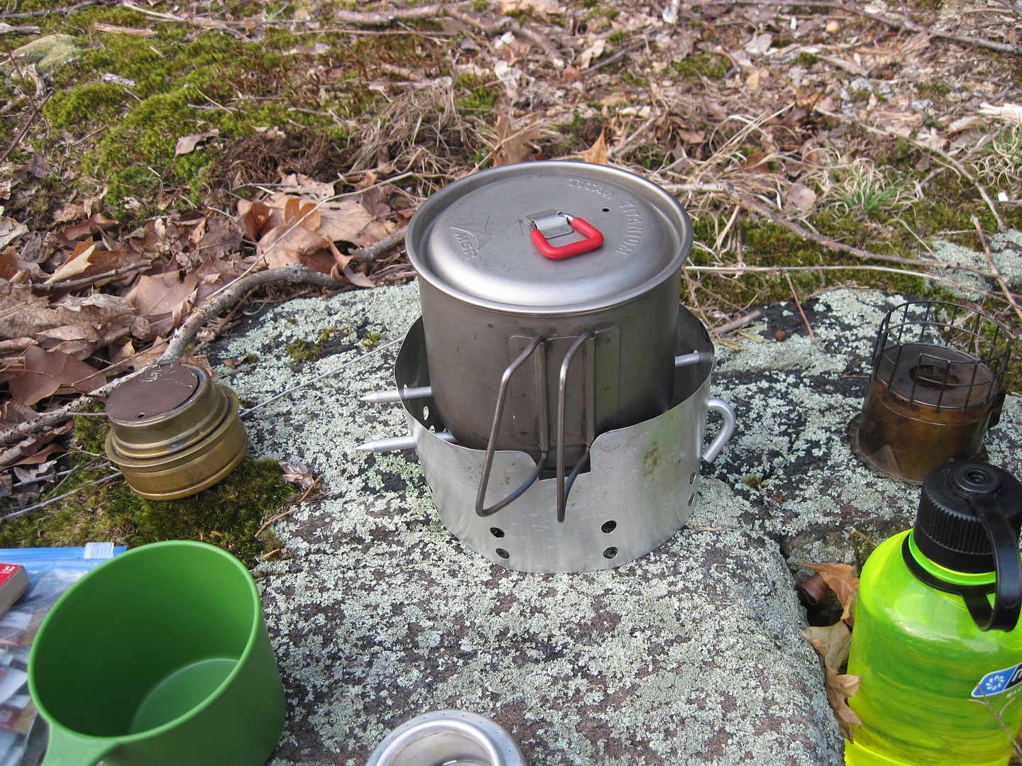

Post by Woods Walker » Wed Apr 13, 2011 9:58 pm
All stoves get tested before fielded and if possible that tends to happen here. In this case I was testing ducky's stove and took the others for comparison.
The spot is an overlook on a blue trail. It’s on top of a river valley and is windy more often than not. The back yard is sheltered and not all that indicative to actual field conditions. It’s not uncommon for people to cook/boil at such overlooks on rocks etc.
We have a Trangia double walled, Brasslite double walled chimney, standard double walled Pepsi can and ducky's stove.
http://www.trangia.se/english/2913.trangia_stoves.html" onclick="window.open(this.href);return false;
http://brasslite.com/" onclick="window.open(this.href);return false;
The Pepsi can stove construction information.
http://web.archive.org/web/200701100833 ... ruct.shtml" onclick="window.open(this.href);return false;
Ducky's looks like a Penny type stove but you will have to ask the OP.
On a side note the semi clear white Nalgene bottle makes for a good alcohol fuel bottle that people won't try to drink from. I tossed the stove inside my windscreen/pot support to boil up some coffee. My windscreen is a bit on the marginal side and have been thinking about making another with higher walls but never seem to get around to it.

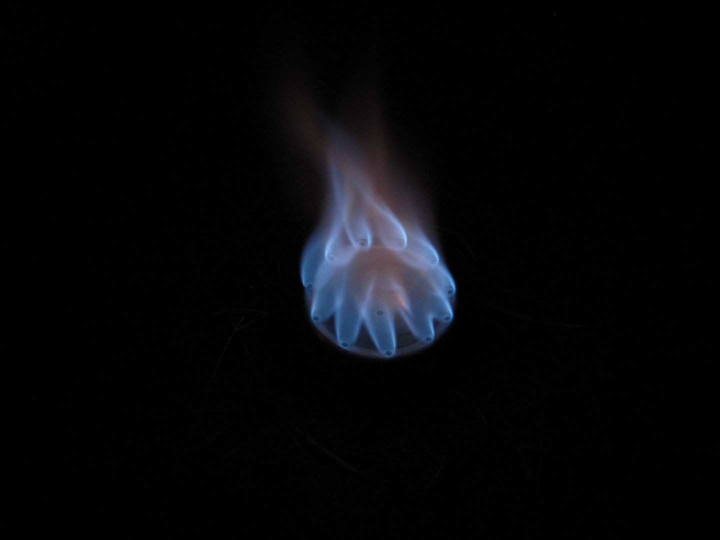

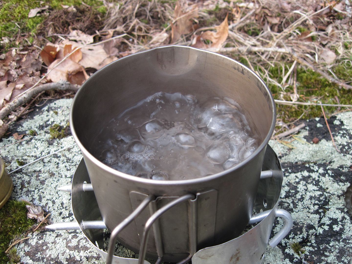

The stove got a rolling boil as expected for the design.
The performance was on par with the others but being in a windy environment didn’t keep track of the boil times. A few strong gust would influence the times so was just looking for a boil. It burned mostly blue which is a positive in my view. For some reason too much red/yellow during an alcohol burn makes me frown. :lol:

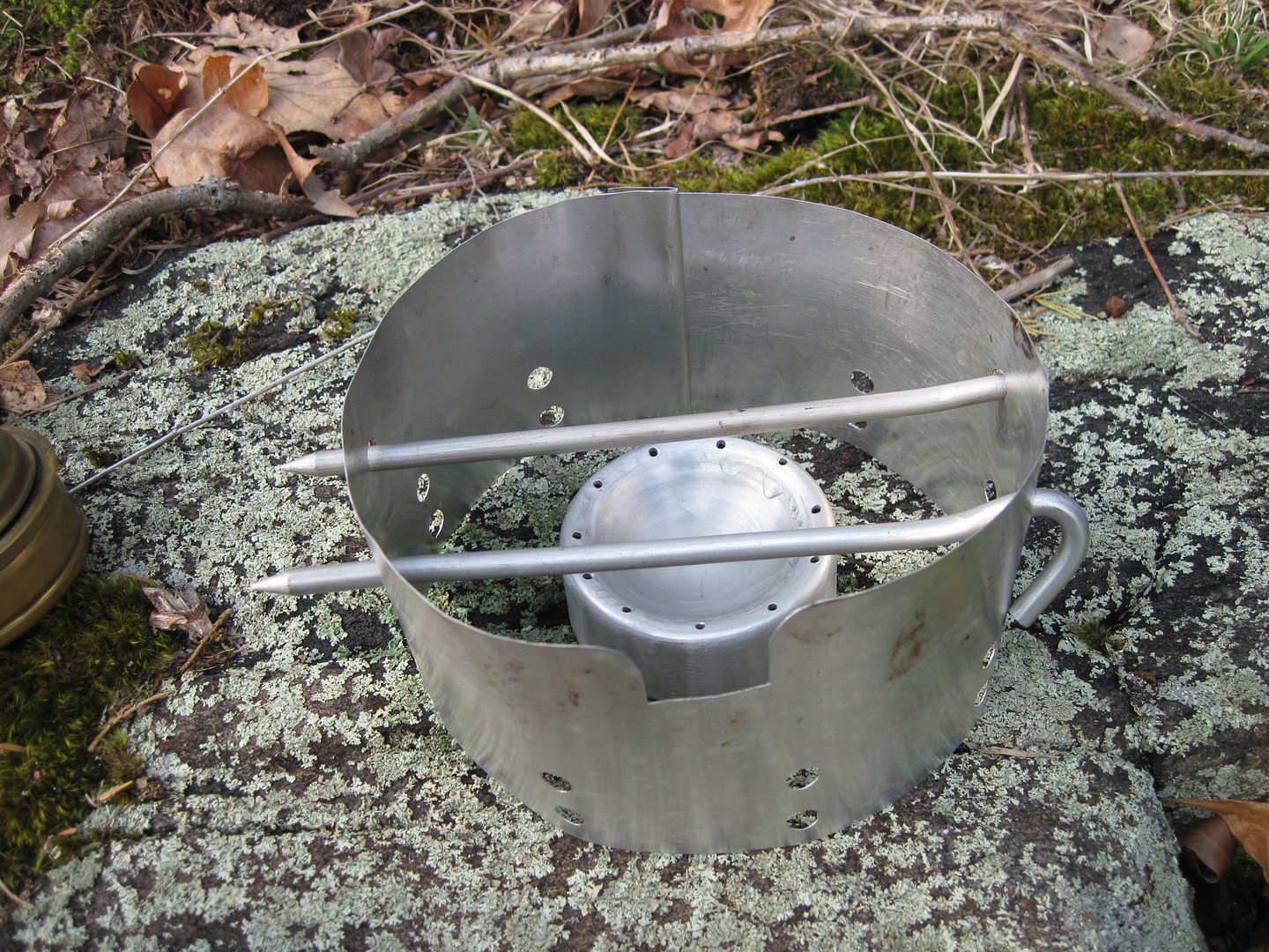

Pros:
1. Heavier than a standard Pepsi can stove but less than the Trangia. Basically all but the most crazed gram weenie would be happy.
2. Feels very very solid. I didn’t worry about it getting crushed in my pack. It could be first or second in terms of durability but didn’t want to start smashing stoves.
3. Burns clean.
4. Vent holes looked drilled and well spaced. Time was spent to ensure no sharp edges anyplace on the burner.
5. If the stove is filled enough it didn‘t require priming during the tested conditions.
6. I think this stove type has a greater pressurized burn and is considered by some to be more efficient than the other types shown. I didn’t test this aspect but just putting that out there for consideration.
Cons:
1. The lowest fuel capacity of the group at 1.8 oz with fuel filling the cup. The Pepsi can held about 2 oz, Trangia around 3 ¼ oz and Brasslite 2 ¼ give or take ¼ oz on all accounts as my fuel capacity test used a 1 oz bottle which isn’t exactly scientific methodology. This didn‘t prevent the stove from boiling and thereby passing that test but still it was the lowest in the group.
2. The small center hole makes fueling the slowest of the group.
3. Unless the stove is filled beyond the fueling hole it might require priming. The brasslite requires priming at times as well as despite the double wall its still a chimney type. Stoves like the Pepsi can with inner wall self primes the best in my view.
4. Requires a wind screen to boil water in field conditions. This is the case with ALL the stoves shown and simply stating this fact as a reminder to those new to alcohol stoves. Only the Brasslite came with an integral pot support but again this isn’t a knock against the others rather a pro of the Brasslite.
5. Only the Brasslite and Trangia have a means to lower the output. I could also make a simmer ring for my Pepsi can stove but never found the need.
Conclusion.
This is probably the strongest build of any aluminum alcohol stove I have ever used. Heck I even reinforced one of my Pepsi can stoves with an Al flashing inner wall and it’s a total wimp in comparison. I don’t think stepping on the burner would crush it. It boiled up the coffee as well. :)

I bought (I know, that's a heresy, but I have R.A. and can't trust my hands) a "pop can stove" from someone on the Internet. If necessity requires, I can take it apart and use it as a model. Wouldn't care to have a spare, at the weight.
For fuel I only use grain alcohol, as it's a multipurpose liquid. Good for disinfecting wounds (OW!), and even drinking if there's a need (alcohol is an excellent muscle relaxer for someone with, say, a broken leg that's spasming, or even as an impromptu sedative. It also works as a tranquilizer for someone who's going hysterical on you when you're trying to help them. It isn't the best drug, but it's a usuable one. A pop can stove with a pint of grain alcohol in the backpack will last a very long time if you're just sterilizing drinking water or re-hydrating ramen or freeze-dried meals. If heat's a problem you can just soak the ramen (it's boring, but far cheaper than Mountain House meals), and the little stove puts off no smoke and very little light once it's perking.
It's difficult to carry a week's worth of water, especially if you're carrying for two (or more), or re-hydrating food. I keep a good filter bottle and extra filters to supplement it, and although the simple filter bottles are slow they're adequate for the purpose.
I have two BOBs - one is a camo model with a bladder, and another that's an innocent-looking common frameless pack. I figure that my wife can put the light stuff in the larger common backpack, while I watch over her with the heavier but small water-bladder pack that's full camo, my bug-out clothing of choice. The latter pack also has slideable side mini-packs that would be ideal for a handgun and ammo, and I have an M-1 carbine for midrange work.
For us, though, we have a problem with bugging out - both of us have ruptured lumbar discs, I have RA and she has two replacement hips, one of which is misbehaving, and a badly repaired ankle that suffered a compound fracture of both shinbones; so, bugging out is a last resort. I wish we could lay in a supply of Vicodin/Lortab but with the "War on Drugs" laws the way they are I don't see it happening so I lay in plenty of Advil and count on hurting some for both of us. I doubt if we'd try for more than moving a few hundred yards from the house to higher ground where we'd have a good view of the house where most things are stored, scattered about so they'd be difficult to loot quickly; they'd have a long time of exposure in order to find the things they want, and that gives me time to retaliate if there aren't many of them - then I'll have our stuff, and their stuff too. There's spring water up there, and it's so steep that very few bad guys would think it worthwhile to make a sweep of it just in case someone was holed up there. They'd be at one helluva tactical disadvantage as well, so while we might have to just watch someone loot the house, we'd be fairly safe. I also carry an easily camo'd shelter, and as I said, that's billy goat country where someone approaching needs either to stick to the dog/deer path or use ropes. Either way, they're toast if they try it.
Just a thought, and some loose plans.

Post by Ducky » Sun Apr 17, 2011 10:37 pm
Cpt. MelonBuster wrote:Would I be able to get it with the pot for $40, if you have more pots like this one? :D
I have been threatend with my life if i sell that pot.
It WAS my wifes when she WAS in the girlscouts. It is very different now from when she was in the girlscouts but she really likes it.

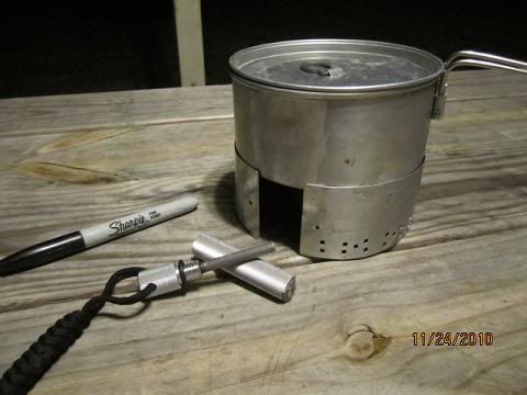

I can make another one. Im not sure if i can do it for $40 but I will work on that and get back to you.
Just to give you a run down on what this franken pot is.
Started out as a 3/4 quart pot from a girl scout mess kit.
This one has a nostick coating and no previous handle, This may be a better canidate than mine was
Then I took the handle from one of these
I rivited the new handle onto the pot so that when i flip the handle over and close it, it holds the lid down somewhat.
I had to remove the old hoop handle on my pot which left 4 holes from the rivets.
I had to have these welded shut at a local shop and then ground it back down flat.
I will see if I have more pics of the pot and post them up latter.
