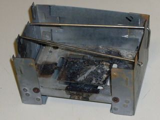

Having trouble using that cup on the ol' Esbit to heat up your dinner? Do you balance the cup on a partially closed stove - but worry that it will tip over? In searching the site, I did not see anything on this.
Well, here is a set of mods to the stove that should fix that problem - and allow you to use a USGI canteen cup or commercial cook pot on your Esbit without worry.

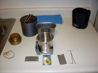

This shows the cup, the problem and parts needed to fix the problem.
This shows the spoke parts in place and one windscreen piece in place.

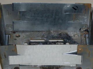

Set up like this, you can burn wood to cook with as well.
With both windscreen parts in place. Very stable for USGI canteen cup or other larger cook pot.

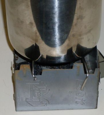

Here is the stove with a USGI canteen cup

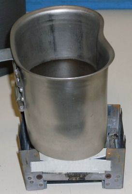

and a commercial 'camping cup'

Question...
What is the third rectangle of metal used for? The one with the yellow tag. Leftover metal? or... Guessing it could be used in the bottom of the esbit stove to keep the bottom from burning out?

Awesome! The esbit is my stove of choice so I will definitely be doing these mods to it! Can you measure your windscreen pieces and spokes so I can cut some out the same size?
Posts: 8244
Re: Modify your Esbit stove to be more "user friendly"
Post by TacAir » Sun Dec 25, 2011 12:18 am
AKFTW wrote:Awesome! The esbit is my stove of choice so I will definitely be doing these mods to it! Can you measure your windscreen pieces and spokes so I can cut some out the same size?
I did these 'by eye. The measurements aren't critical. And there are several different 'Esbit' stoves out there.
A pair of aviation snips are easier to use than the older sheers.
The spokes were bent, laid across the stove and bent a second time, then cut.
Good luck.
