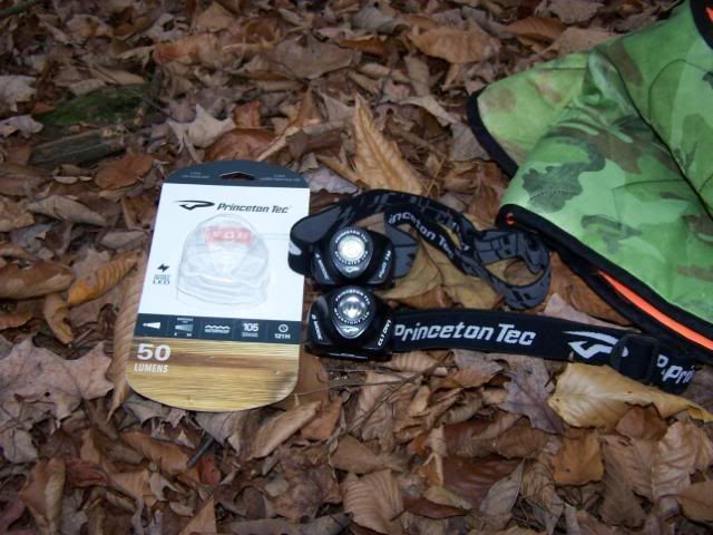

The newer headlamp has the 50 lumen rating right on the package. Both the EOS and EOS II are physically similar. The PT marketing department has decided to finally give the type of LED in addition to “Maxbright”. The Rebel 4-mode EOS is priced between 34-43 dollars

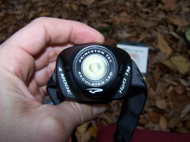

Both updated headlamps have the same frosted optic. The older EOS has a clear optic. Here is a close up of the EOS frosted Optic.

Both headlamps share many of the same characteristic so I will try and not repeat the same information for this review. The differences between the EOS/EOS II are within the UI. PT does mention something about chemical resistance plastic of the EOS II however I am betting that both headlamps are made out of the same stuff. The EOS II does come with a rubber strap in addition to the stretch cloth for attachment to a hard hat. The EOS II is a two mode light. Just high or low. The user can switch between modes by simply pressing the recessed button. The switch on both headlamps is a bit stiff but this is not a problem as it helps reduce accidental activation within someone’s pack.
PT lists the ratings as the following:
1. High is 50 lumens with no throw rating.
2. Low is not listed.
The spotty listing is due to the packaging of the EOS II. Being an industrial work headlamp the packaging consists of a box with just the light and extra rubber strap in plastic wrap. No instructions are provided. But though testing I have found the high rating is a true solid 50 lumens with a longer than listed regulated runtime. Maybe two plus hours rather than the 1-1.5 of the 4-Mode EOS however this is just a guess based on my naked eye and maybe proven un true if anyone ever does a scientific test. I see no reason not to think the total runtime isn’t near the 120ish hours of the 4-mode EOS. The low setting seemed like 10ish lumens. My test showed a regulated runtime of around 13-14 hours based on timed hikes/camping usage but again I could be wrong. I think maybe the total runtime would be between the medium and low modes on the 4-mode EOS. So guessing the runtime on low is 13 hours regulated with a total 114 hours.

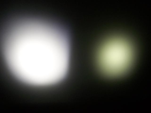

A beam shot of the 2-mode EOS II high compared to the 4-mode EOS low.
The 4-mode EOS low is nice and low just like it should be.
A beam shot of the 2-mode EOS II low compared to the 4-Mode EOS high.
The EOS II low is between the 4-mode EOS low and medium.

The EOS beam is a good mix of throw and flood. The older EOS was mostly just throw. They overcame this with the frosted optic and a modern LED. I think a Q5 Cree puts out more lumens and maybe more efficient than the Rebel. I don’t know what the bin designations for Rebels are, maybe 80 or 100 but just guessing. However the tint and beam quality of the Rebel is superior to the Cree and I am guessing this is the reason why PT went with the Rebel. This is mostly babble on my part. The bottom line is the EOS can throw farther than the Tikka plus but still work for in camp use due to the frosted optic and maybe changes in the reflector too. However if pure flood at the expense of throw is your primary concern than the Tikka maybe be your pick. Overall the EOS is superior in every other way to the Tikka plus minus the greater flood at closer ranges and bit less bulk. Still I like the Tikka plus and always feel the need to own a direct drive 3xAAA headlamp when looking to juice every last lumen. This is why I got one to replace one of my 3xAAA direct drive Auroras after the latch broke. The Aurora latch is one of the big negatives to an otherwise fine headlamp.
