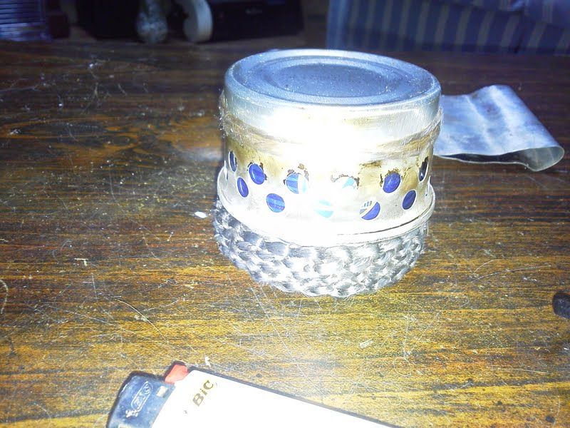

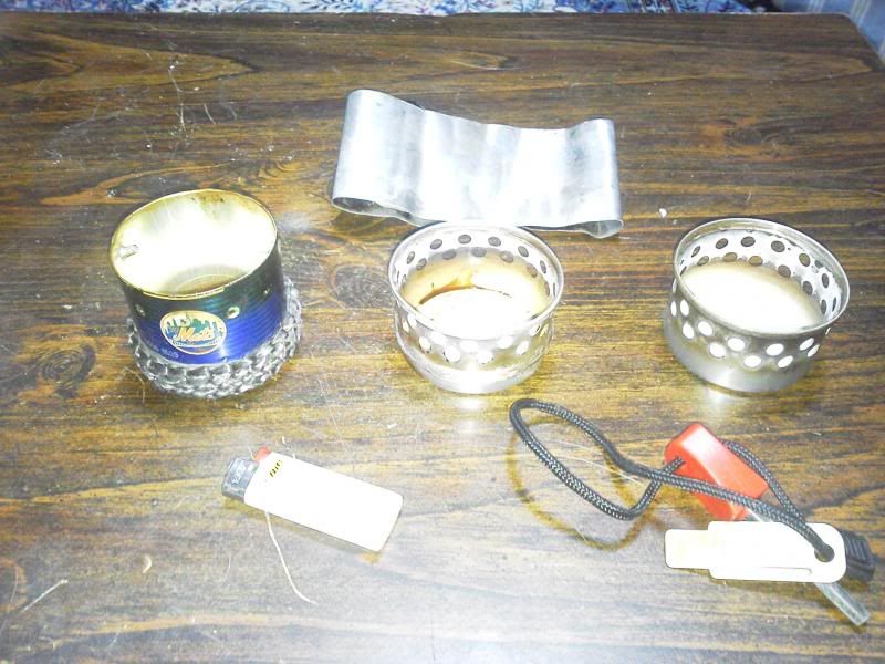

I experimented with a bunch of alcohol stove designs (only a small fraction of what is out there, but a bunch!)
I settled on two, well... three.
The "Cat Can" stove is so incredibly easy to make, light, and use, there really isn't much excuse for using anything else. http://andrewskurka.com/2011/how-to-mak ... hol-stove/" onclick="window.open(this.href);return false;
One "problem" with it, if you like to use a Heiney pot it is not very stable on a Cat Can. So I still use my Klasslite stove.
https://m.youtube.com/#/watch?v=lQc3L8n ... Qc3L8n5kqY" onclick="window.open(this.href);return false; While incredibly light, it is still a whisker heavier than a Cat Can and way, way slower to boil but that's the price I pay to carry the Heiney pot.
Before the Cat Can, I was a really big fan of the Bud "Cottle" stove, a knock-off of the White Box stove. http://www.backpackinglight.com/cgi-bin ... bNPq8u9KSM" onclick="window.open(this.href);return false;
Quite by accident, I found the Cat Can nests perfectly over the White Box knockoff. This gives me two very good burners in a very small, convenient package. So, I keep the Cottle stove around for those times when I still want to use alkie stoves but might want two burners, all in a compact package.
Here's most of my starting lineup (not sure where my Klasslite has gotten to...
And here's the nested Bud Bottle stove/Cat Can stove

Festus Hagen wrote:I experimented with a bunch of alcohol stove designs (only a small fraction of what is out there, but a bunch!)
- The "Cat Can" stove is so incredibly easy to make, light, and use, there really isn't much excuse for using anything else.
- the Bud "Cottle" stove, a knock-off of the White Box stove.
- Klasslite has gotten to...
Completely agree. I played around with the penny stoves, the fancy multi wall stoves, etc and have ended up very happily with the the CatStove (I made the traditional FF one and a larger one made out of a container for oxygen sensors that's 2x the capacity at the same height - works best with my kettle), and something close to the "Cottle", which is basically a Venom stove.

ninja-elbow wrote:I've never even tried a CatStove - I've seen them, read about them, watched a friend fry eggs with his and a small teflon skillet... but never made and used one myself. Might as well, I have a small stock of the cans.
Do it. While I feel there is no truly "best stove" (different horses for different courses), the Fancy Feast has the following going for it:
1. It would take me longer to find my hole punch than to make the stove. I'm not too organized, but I'm saying it's an easy project :)
2. No moving/joined parts.
3. Lightest weight of any stove I have tried. Even the Klasslight is significantly more weight.
4. No pot stand required or even wanted.
5. Easy to light, quick priming (wastes little fuel)
6. Total construction cost, even if you have to buy a flexible ruler, sharpie, can of cat food, and hole punch, should be $5 or less. I had to buy a hole punch which cost about $2 and a can of cat food which was around $.59.
7. Make two of them, and even if you need more burn time than one FF stove can manage, you can simply fill and light the second stove as the first one starts showing signs of going out and transfer your pot, back and forth between stoves ad nauseum if need be.
8. I don't know that it's the fastest or most efficient alcohol stove to boil 2 cups of water with, but it IS fast and efficient. I think the "jet" effect of the relatively higher "pressure" stoves is overblown (just IMO).
9. If you want to use it in winter, just find some fiberglass string and wrap/tie it around the base of the stove as a wick. Spill a little fuel on the wick when fueling up and it will light right up even well below zero.
Don't get me wrong, double-wall stoves like the White Box and it's knockoffs, and other designs are hella cool. I've always admired Tinny's Bios and Atomic designs over at Minibulldesign.com. If I'd just lose a few pounds I could probably stand on my White Box knockoff, if I tried that with my Fancy Feast I'd have a flat useless piece of metal. That is still my go-to stove for car camping when I'm looking to use an alcohol stove, or canoe/kayak camping, and it works great in winter. Some of these stoves will burn a lot longer and/or have simmer rings which are handy if you're doing more than boiling water for cocoa or Mtn House. Still, the Fancy Feast stove is genius in it's simplicity and effectiveness. I know "I prefer" and "Me too" are pretty hard data points to argue with :rofl: but definitely give the Fancy Feast a try.
