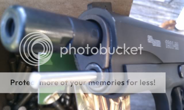

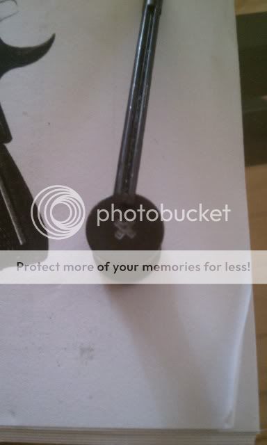

Re: Sig 1911-22, starting to fall apart.

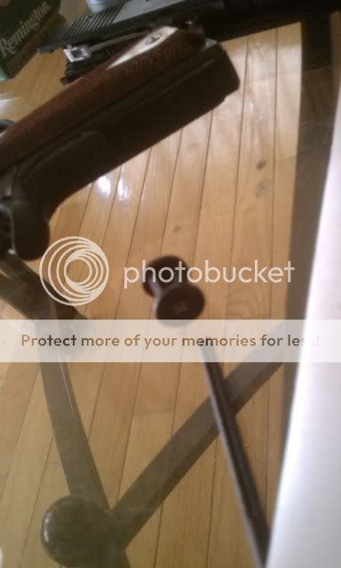

Well, after shooting around 200-300 hundreds rounds my Sig 1911-22 the recoil spring guide snapped! It completely snapped where it meets the rod to the main body. I have to call Sig tomorrow and nag at them to send me out replacement parts. Pics coming

Re: Sig 1911-22
Just called Sig, their Customer Service was nice, polite and overall good. Just simply told them what the problem was and he just asked my name and address and said he'd send the part out right away. I did ask if this was happening often and he mentioned that he's had to send out quite a few of them already. So I'll report back after I receive it. ATI had this very same problem with their early models and replaced it with a different sold model so I'm hopping Sig has done the same and there won't be anymore issues.

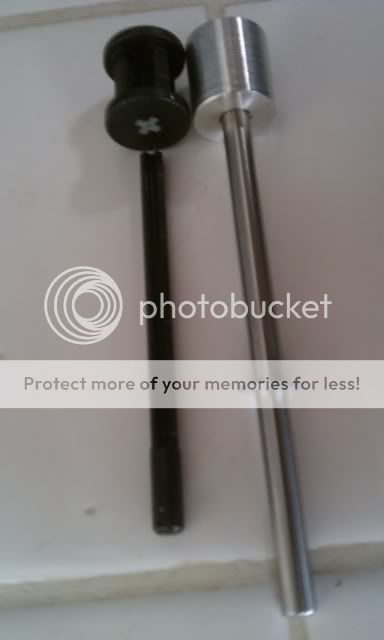

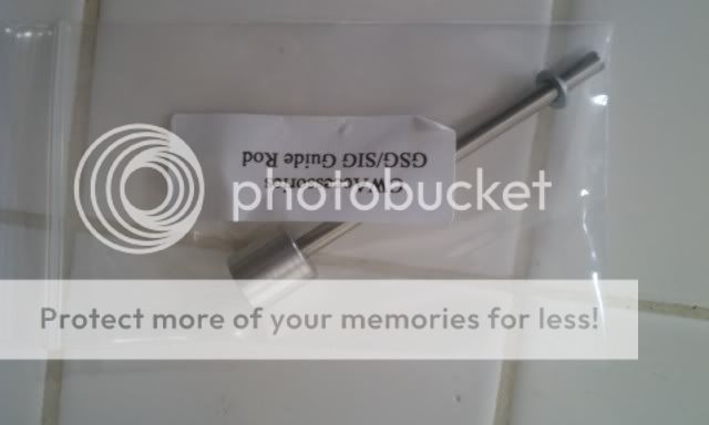

Re: Sig 1911-22
Ordered a extra, better Guide rod today from http://www.cwaccessories.com/" onclick="window.open(this.href);return false;
For only $16 bucks shipped you get a lathed SS and aluminum rod. So really looking forward to that. Hopefully the gun will be running by mid next week and I can put another 500 rounds through it and then maybe post a review.

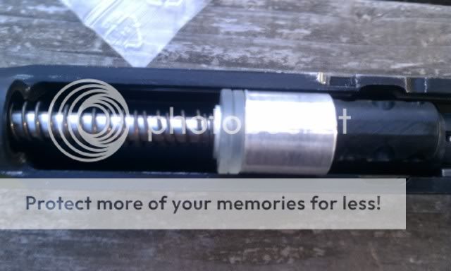

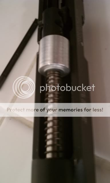

Re: Sig 1911-22

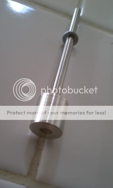

Well got the new recoil guide rod from CWaccessories and it looks pretty good and solid.
Installed it right into the pistol.
Only problem was because the rod is oversized the old plastic washers wouldn't fit, just they do include a small metal one. Shot about 50 rounds through it and kept running into a problem, the barrel bushing would keep rotating and beat up the end cap for the rod.
So what I did was bore out the plastic washers to increase tension.
Now she's running flawless and hopefully she'll keep running. I must note that the finish sucks, as you can see in photos the finish looks like the rounds has 1000's of rounds through it, not only 400. The Sig will probably get AlumaHydeII coated in park gray, just the slide to start with. Will keep updating as more rounds go though and problems present.
