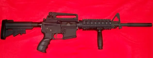

Well then. I guess I have a fighting carbine. I know it has functioned flawlessly in the two courses I took, and I will be testing my new upper in the next one. I also have no Gripes about buying an Armalite, its been a great rifle so far. It shot better than most rifles at the last class.
