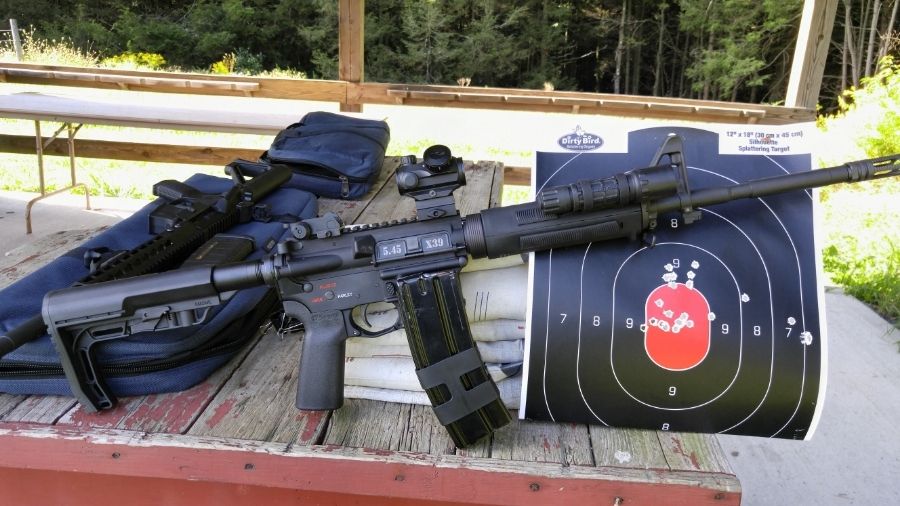

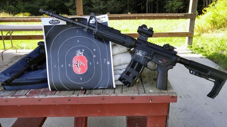

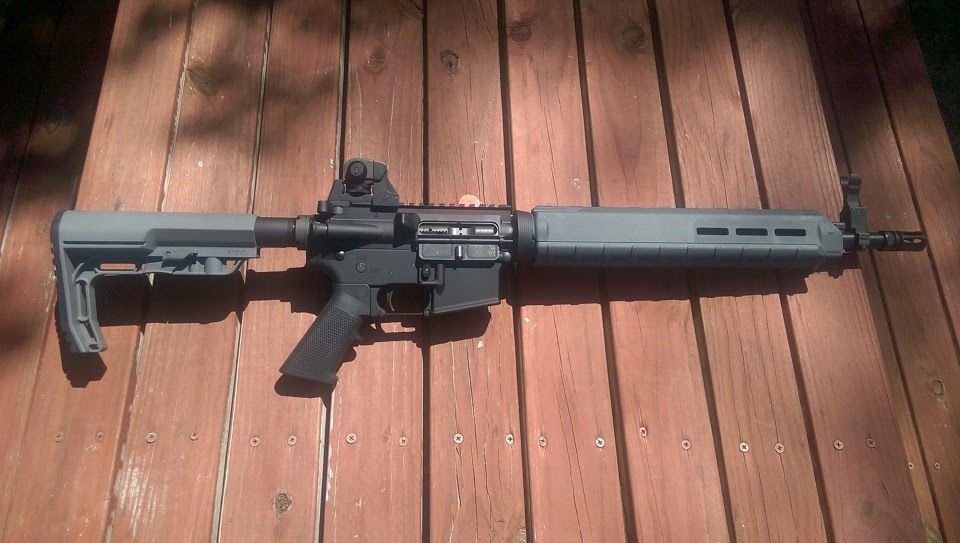

I put about a hundred bucks into the Pirate and here is what we Have
I went with
Mission First Minimalist stock
B5 Grip
B5 Keymod Handguard
BCM Keymod Flashlight mount with my Surefire G2
Yankee hill Phantom 2 Flash hider (in case a pirate needs to use it as an impact weapon)
Mission First Mag coupler
The B5 handguard goes well with the retro handguard cap.
I found some rubber keymod grip panels for 7 dollars made by Ergo grip.
The B5 is very skinny and the rubber helps with keeping a solid positive grip on the rifle.
My only complaint about the B5 Handguard; no mounting directly under the handguard for a foregrip. I bought a BCM angled grip at the same time that I bought the handguard thinking I would be able to add a grip. Waste of money since there is a lack of mounting at the 6 o’clock position.
Rick Shaw
Posts: 634
Re: The Pirate: Ar chambered in 5.45x39
Post by Rick Shaw » Sat Aug 29, 2015 3:03 pm
Forgot to mention....I was thinking about a bayonet....I haven't decided

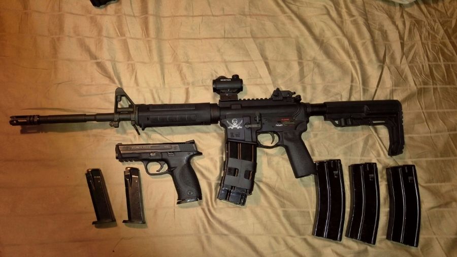

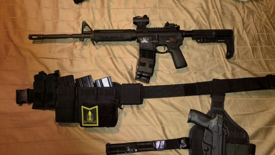

I found the pirate a mate:
A M&P full size chamber in .357 Sig (Another nasty neck down round)
I set up a war belt for them too:
An Eagle Industries belt with (Moving left to right)
-Older style Blackhawk pistol belt pouch
-ESS tactical (Only available at SKDtac) 7.62 triple shigle with 5.56 kydex incerts
-Milspec Money Velcro panel with zipper pouch
-Greyjoy Velcro patch (We do not Sow)
-ESS Tactical belt mounted rolling dump pouch
-Eagle Industries leg drop with G-Code RTI mount
-G-Code Kydex RTI holster for M&P
-Blue force gear double pistol pouch
This set up should work well for raiding merchant vessels in the Bahamas

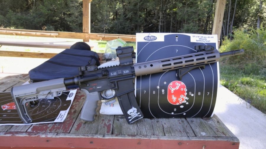

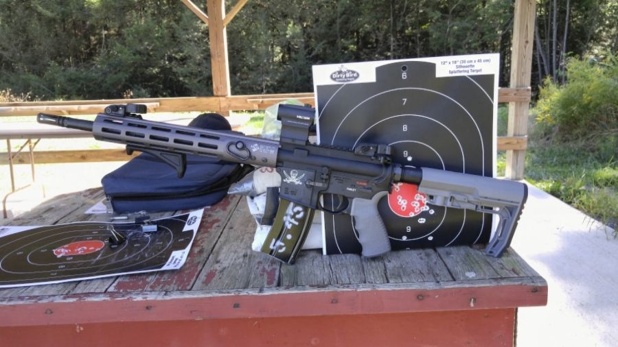

Over labor day I was shooting with my brother-in-law (Huge AK74 shooter who doesn’t own a single rifle chambered in 5.56 or .223).
He loved the 5.45x39 AR and made me an offer on the upper I couldn’t turn down.
So I used the money made from the budget upper to build a serious and practical upper to go with the pirate lower. The pirate is now a more solid war fighting weapon instead of a tacti-cool novelty.
Target shot at 25 yards in the standing using two strings of rapid fire with a mag change between strings
Most of the parts used were bought over the last few months when they are on sale or clearance. I pick up parts all the time to have fodder for future builds.
I used another Yankee Hill stripped upper because it matched the spike’s lower and I ordered another 5.45x39 dust cover from Tactical Galaxy. I found a tear drop forward assist made by bushmaster from an on-line parts liquidator. I always go for tear drop over round when I can.
The sights are polymer Diamond Head Tactical I got from Primary Arms some 4 months ago when they were on clearance for 70 bucks.
https://www.primaryarms.com/Diamondhead ... p/1499.htm
The flash hider, gas block, gas tube, bolt cam, and bolt carrier are all VooDoo Innovations with life coat I got from Fourguysguns on half off sale two months. Voodoo life coated parts are pricey but the half off sale let me pick up most of the parts I needed without breaking the bank.
http://store.fourguysguns.com/brands/Ad ... t=featured
The only VooDoo part I had to pay full price for was the bolt at $100 direct from there website.
The Barrel is Ballistic Advantage 14.5 inch government low profile barrel chamber in 5.45x39. At 25 oz it is just 4 oz heavier than their low profile pencil model but it has a .750 gas block (Instead of .625) which meant I could use the Voodoo life coated gas block I already owned. The sale price for the barrel is currently $166 but I bought it over Labor Day weekend which knocked the price down to $142 with free shipping.
http://ballisticadvantage.com/14-5-inch ... arrel.html
Another plus to the Gov barrel (With .750 gas block) over the pencil (With .625 gas block) is that I get the full benefit of the VooDoo manimal flash hider that is design to allow a .750 gas block to fit over it when pinned to a barrel…such as I had to do to make the 14.5inch barrel legal on a rifle.
http://store.fourguysguns.com/vdi-manim ... ash-hider/
I wanted to go grey with the new build. I love the grey movement in gear and I own a some gear in grey I can adapt for this rifle. I don’t care about practical purposes of using Grey as a camo pattern…its just my favorite color.
I bought an ALG Defense 12 inch gray EMR rail with M-Lok system a few months ago for Dissipator upper build. The 12 inch rail was too short for the rifle gas system so I didn’t use it for the Dissipator. I held on to the ALG rail in case I needed it for another project.
http://algdefense.com/rails/emr-v1-m-lok.html
I finished the build with Mission First minimalist stock and grip in grey. The grey Mission First uses is very light and will not match Wolf Gray or Stealh grey. It is passable with the grey that ALG uses…but just barely.
Using grey, I decided to get some color on the mags to break up the black. I made a 5.45 stencil and got a Skull and bone vinyl airbrush stencil from Micheal’s hobby store. I used Kyrlon gray primer with Enamel clear coat. I’m not entirely happy with the paint job, but what can you do once the paint sets in.
The optic is a brand called Holosun. It’s a Chinese Aimpoint knock off that promotes 50,000 hours of run time on a single battery. That’s the base model. The more expensive models are dual powered with solor being the secondary power source. I went for the base model with an AR riser which goes for $160 with free shipping on Amazon (Using my saved points I only paid 60 bucks).
http://www.amazon.com/gp/product/B00KOO ... R6PNBACFXR
Its compact and light. The battery sits between the mount and the optic which cuts down the power knob. The dot is clear and crisp. My only complaint is the dot started out to the far left. I had to adjust almost 30 clicks right to zero in. When I get time, I’m going to remount and see if that helps the situation.
There is the new Pirate gun. It’s a little more serious and practical now. No more talk of war banners hanging from the barrel or two foot long bayonets. Its still affordable with clearance and sales I scouted out over the last few months.
The weight with the optic and empty mag sits at 6 pounds and 9 oz.
I plan on matching the rifle up with some of the grey gear I have acquired over the last four years. I’ll post when I good rig fit for a pirate. Till next time.

I always have problems linking photos from google.... Trying again.
brothaman
Posts: 1041
Location: SC
Post by brothaman » Mon Sep 21, 2015 7:59 am
I like Ye Ole Pirate better in black. Nothing wrong it the update. I just really dug the B5 hand guard and the LBD like blackness of it. Also, I really hate the Magpul hand guard I chose for mine. It just isn't working well my squirrel paw hands. I might get a mid-length B5 hand guard or another Troy. The folding sight is a YHM bolt on, the rifle has carbine length gas on a cut down a2 sight post. So, I got options.
Oh, and you were right about the MFT stock. It fits perfect and it tough. I like it.
