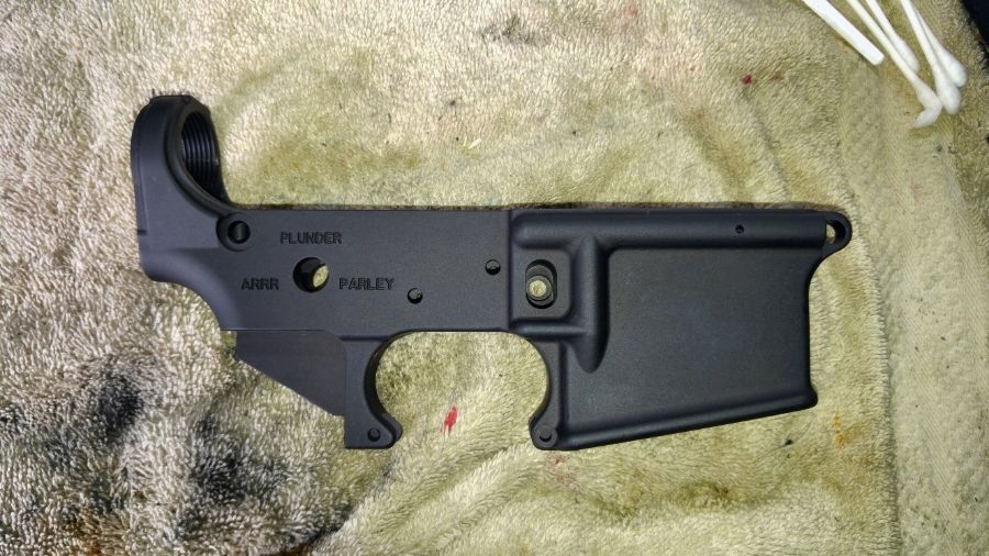

I started searching for Lowers to base my build on.
Primary Arms has had some pretty good deals on Lower and parts kit combos. If you buy a lower you can get a Spike’s Lower Parts kit for under 60 dollars.
On Primary arms I found a Striped Spike’s Calico jack lower with the Pirate lingo in place for the Safe, Fire, Auto.
I thought this was perfect for a 5.45x39 round (Which is a mean looking spike that tumbles through flesh like a cannon ball).
The lower was cool, but it wasn’t color filled like I normally like.
I spent about 5 dollars and I did it myself (Process documented in separate post)
Over all I was happy with the results

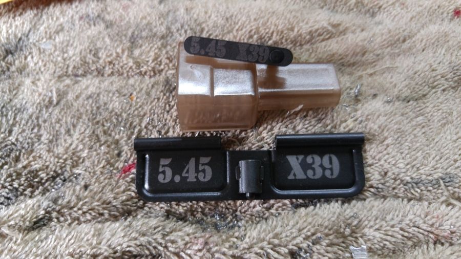

Next, after researching 5.45x39 being used in AR platform, that there were some issues with the hard primers found in Russian ammo. To deal with that off the bat, I found a harden chrome firing pin and wolf extra power hammer spring from Black Rifle Arms for about 20 bucks.
After than I decided announce to the world that this was a 5.45x39 weapon with clear warning signs right on the weapon. I found a laser etched ejection port cover and mag release for about 25 dollars shipped from a company called tactical galaxy. They had other offerings (Such as charging handle, take down pins, and trigger guards) but I didn’t think there was a need to overdo it.

My only issue was that the steel cases played hell with the finish on the brass deflector. It scratched it up pretty good. A simple piece of masking tape could prevent this
