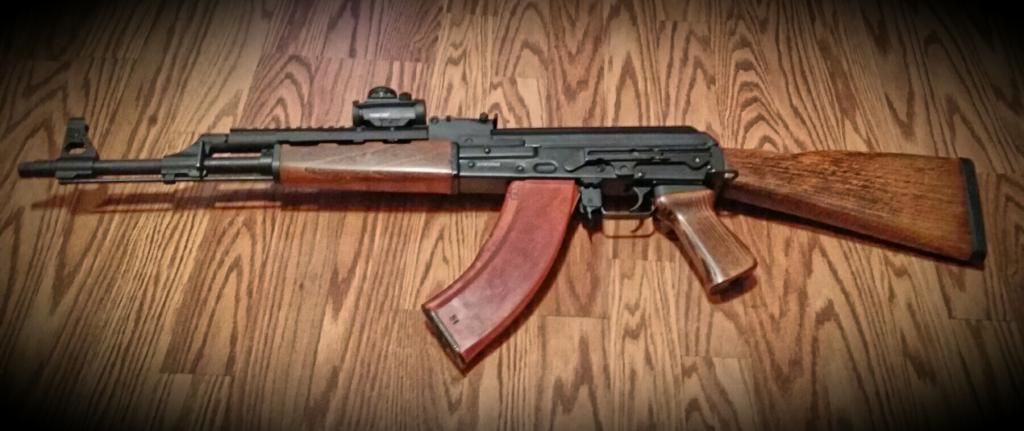

I love my O-Pap. Here is mine with some mods and wood work:
