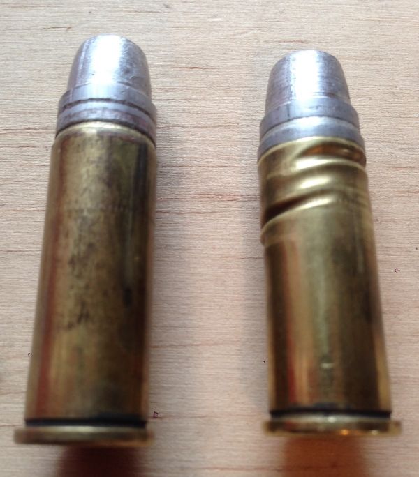

I've been reloading for a couple of months, have successfully loaded 308, and 44 magnum with copper plated lead bullets. I picked up some cast lead bullets to try, as I plan to start casting bullets soon. This happened;
The bullets were advertised as .430". It seems like the top of the lube-groove is catching the top of the case. The cases were well flared. Can anyone school a noob?
Thanks!

Blk Shp, I had the same issue. To Seat and Crimp in the same step, I had to open the case mouth as much as I could and be a "smidge" more generous on initial COAL and lighten the crimp. The COAL tightened up one I set to Seat and Crimp. I thought it was just my press that caused it. I was trying to use a really tight crimp and the crimp was pulling the bullet and the case mouth down causing the crush.
I've moved to Seating and Crimping separately now. Seating separately lets me minimally open the case mouth to seat and crimping separately lets me crimp as tight as I need to.

Thanks Brotha.
I was seating without crimping. I crimp afterwards, and very minimally as I'm loading these for a single shot rifle. I'll try again and see if I can get any more flare on the case, otherwise I'll be picking up a re-sizing die sooner than I planned.

Black Sheep wrote: I picked up some cast lead bullets to try, as I plan to start casting bullets soon. This happened;
One other thing you may try (if you haven't already) is to adjust your expander. The pin (expander ball) that goes down the center of your expander die should be adjustable. Turn it downward a tiny bit and run a shell through it. The expanders are almost always tapered and dropping them lower will create a larger bell on the case mouth. Be careful as you can overdo it an end up crushing cases when you run them through the expander die also (which is no fun if they get stuck also...).
So try dropping the expander 'pin' a tiny bit at a time, along with seating and crimping separately. And good luck.

I solved my case crushing problem too. jiggled the bullet seating die around for a few minutes, took it apart, put it back together, then loaded another cartridge GENTLY. I don't know if anything was sticking inside the die, but I was pushing the lever past the point of first resistance. Even though I know you don't need to apply a ton of force to every step. Feelings of shame subsiding slowly...
